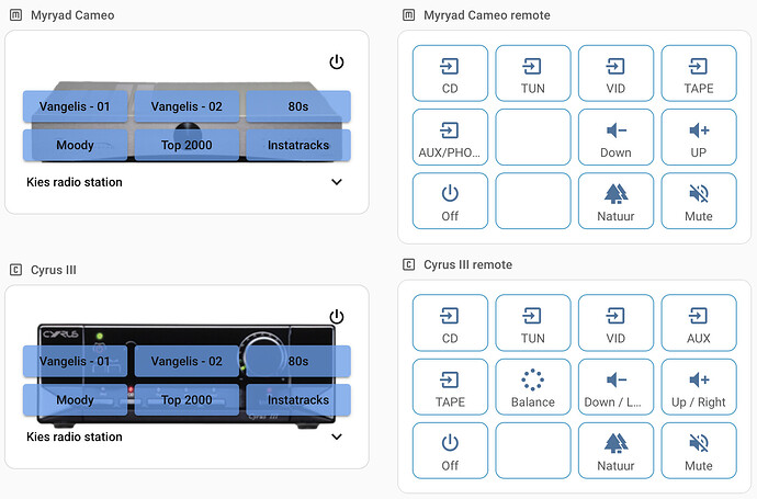

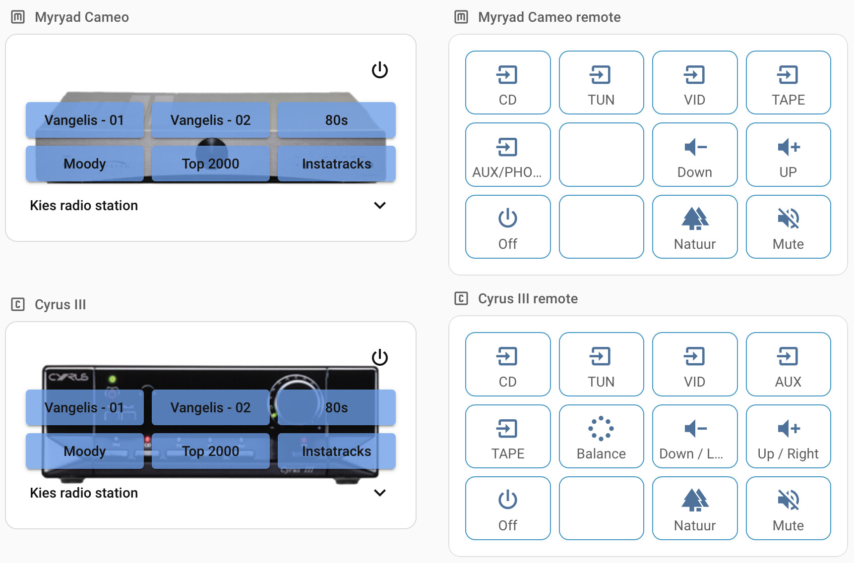

Update: I indeed ordered one and it works quite reliably. The configuring is a bit of a hassle because you need to go into the clusters to read the commands and send them. At least for the sending, I made a little script that allows you to store the codes and then call them with normal names. I included example code for buttons which call this script, to put on a dashboard. For anyone interested you can find them here: GitHub - AllardKatan/MOES_IR_scripts: Scripts for MOES UFO-R11 IR blaster .
