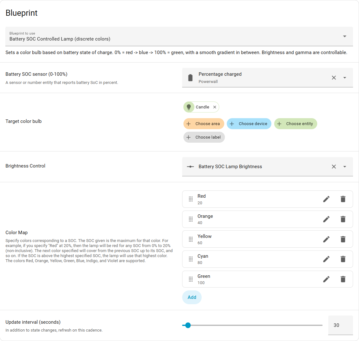

Required Inputs
  • Battery SoC Sensor
    A sensor or number entity reporting SoC as a percentage (0–100).
    Example: sensor.powerwall_battery_level.
  • Target Light
    Any color-capable light entity. Works with most Zigbee, Thread, and Wi-Fi bulbs. It was tested using a LIFX Wi-Fi bulb.
  • Brightness Control
    An input_number that controls the brightness of the lamp dynamically.
  • Color Map
    A mapping between the SOC level and the color used is provided. This is fully editable. The possible colors are: red, orange, yellow, green, blue, indigo, violet, lime, gold, and cyan. The entries in the color map don’t need to be in any particular order. The default values correspond to the values above.
  • Update interval (seconds)
    The automation is triggered every so often to keep the bulb color up-to-date.
Blueprint Image
