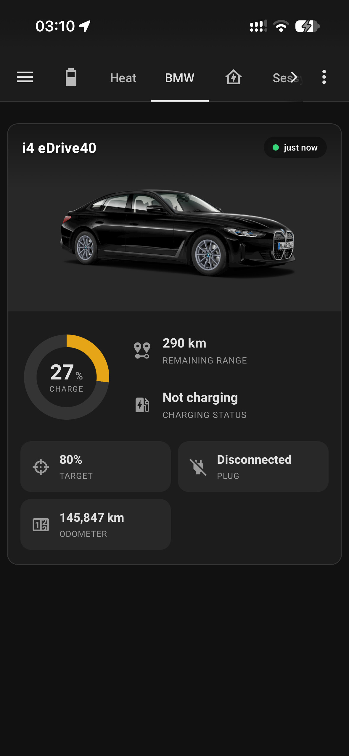

Worked for my BMW I4 edrive40 for ~2 days
Data is no longer updated, en though the card says “just now” on top right (after reload)
SOC is wrong, km number is wrong
Any tips on what I should do?
