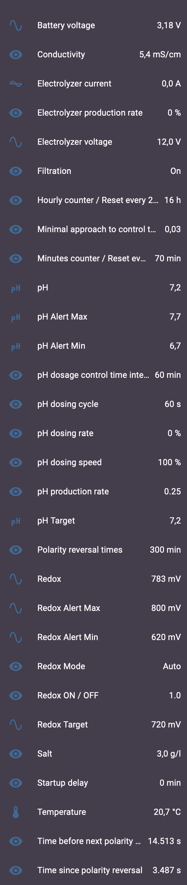

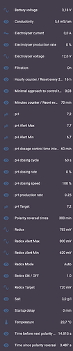

To make it short after installing Multiscrape via HACS you need to add the following script to the configuration.yaml. ON configuration you just need to update your user ID and password for Bayrol web access and update the cid number to match yours in the first link on config.
