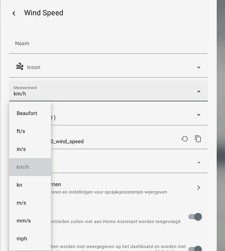

Hi all,
I am battling to make this template work.
My wind value is not in m/s but km/h
I am trying to first convert the km/h to m/s and then apply the template but i am getting silly results.
Is there a way for this template to work straight using km/h ?
Thank you all in advance
I copied mine from another source and I now realize that this is already (!) in km/h ⌠the m/s units added at the end are plainly wrong
