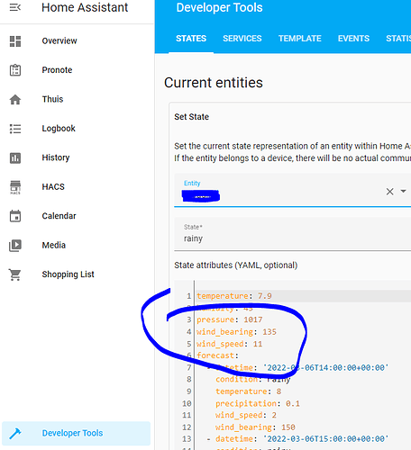

And something else I just noticed, is your sensor called wind_speed? then it may not have an attribute wind speed but it would be the state tiself…pls send screenshot of your entity if unsure (using menu-Developer Tools > tab-States )

Hi Vingerha,
I copied your YAML, double checking the indentations and it was accepted - thank you!
I have included my windspeed entity, it seems it should be simple enough to use the MPH to set a corresponding Beaufort scale, but it’s beyond me.
You have chosen a nice ‘easy’ challenge to start off your HA experience … as ‘templates’ are not easy at all and I am learning since a long time.
Since the value is not in the attribute (as I have, using state_attr) … but in the state of the sensor, change the line to show below, with correction to mph:
