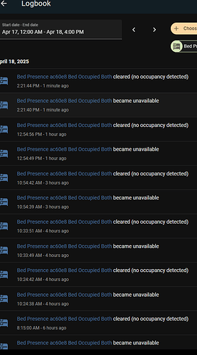

@stephenp93 It’s probably a result of the corner of the house, mattress, walls, etc. but my sensor is having a tendency to have blips of “unavailable” (see below). I haven’t analyzed the length of time but many of them look to be within 10 seconds. Is there a timeout or a retry that you are aware of that could reduce this bouncing?

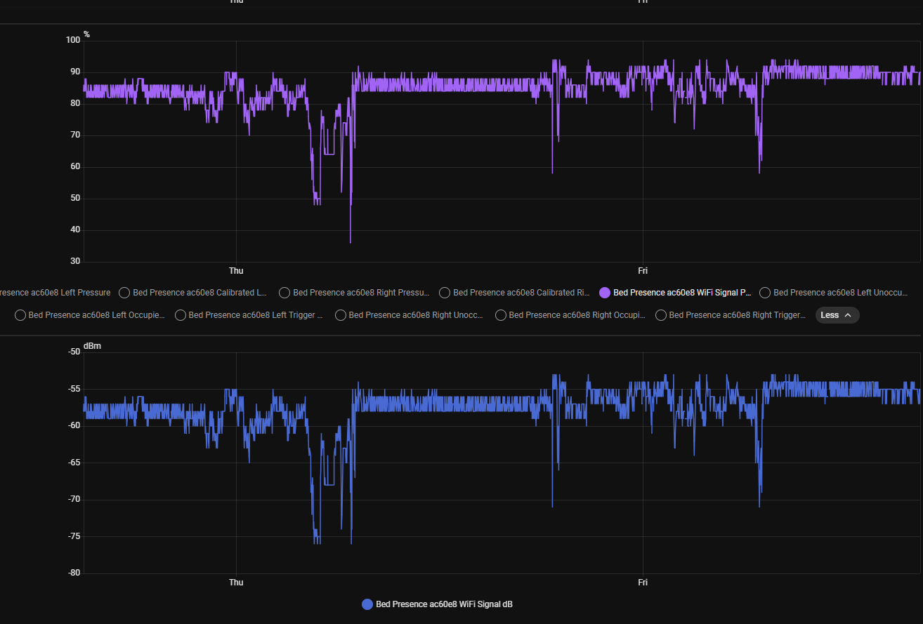

What does your “WiFi Signal Percent” show? Also checkout the “Uptime”. Is that resetting to 0 each time it disconnects, or is it continuing to count up?
Uptime is 290,633s - so definitely not resetting. I’ve been wondering if maybe my little charger may be a little flakey - it’s just an old usb phone charger that does 5v / 1000ma.
wifi is at 90%.
Here’s a history for a few days of the wifi % and the wifi DB. Granted - there are a few days where i would expect some brief blips, but not nearly as many that seem to be occurring.
