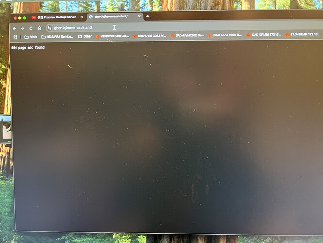

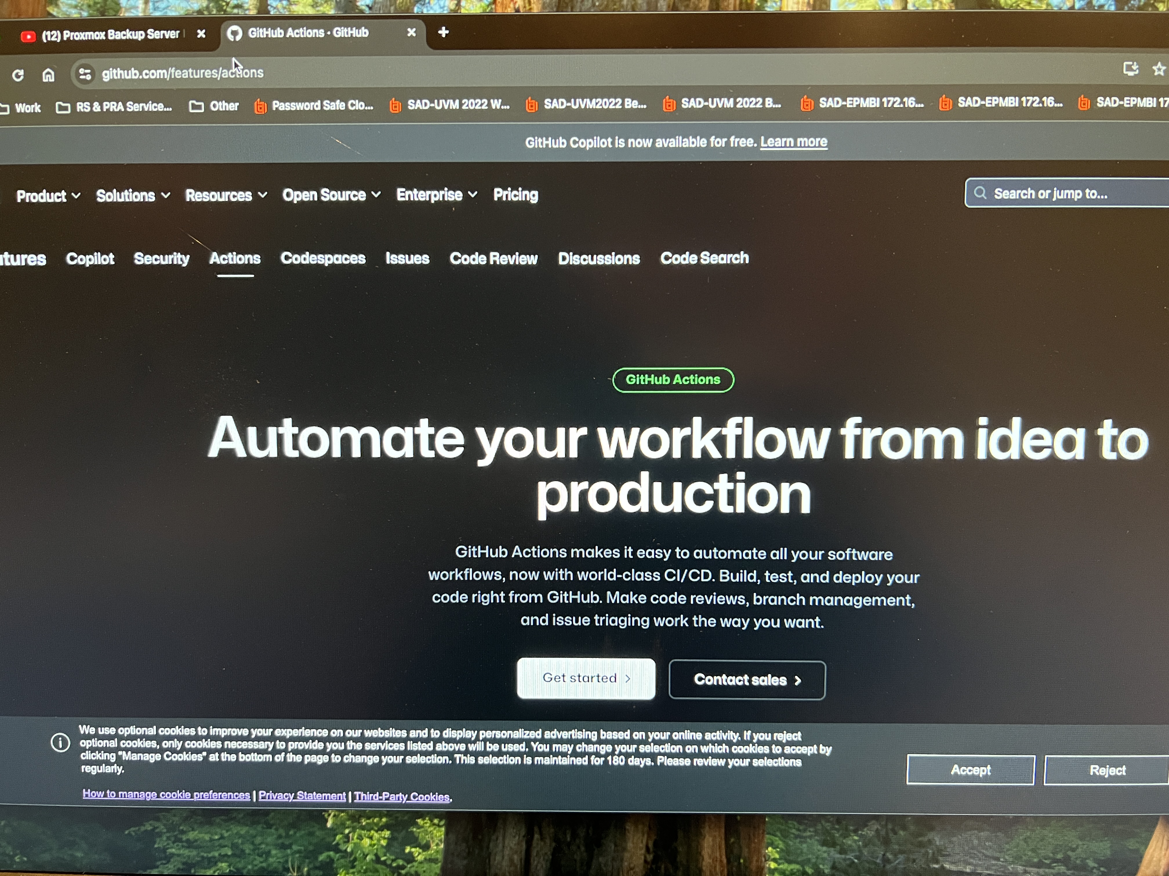

What happens if you try to access
from your browser and ping from your HA?
Try 1.1.1.1 for DNS
Will try that later.
Thank you
Update
First Link from Web Browser works
The second doesnt
How can I ping from Home Assistant?

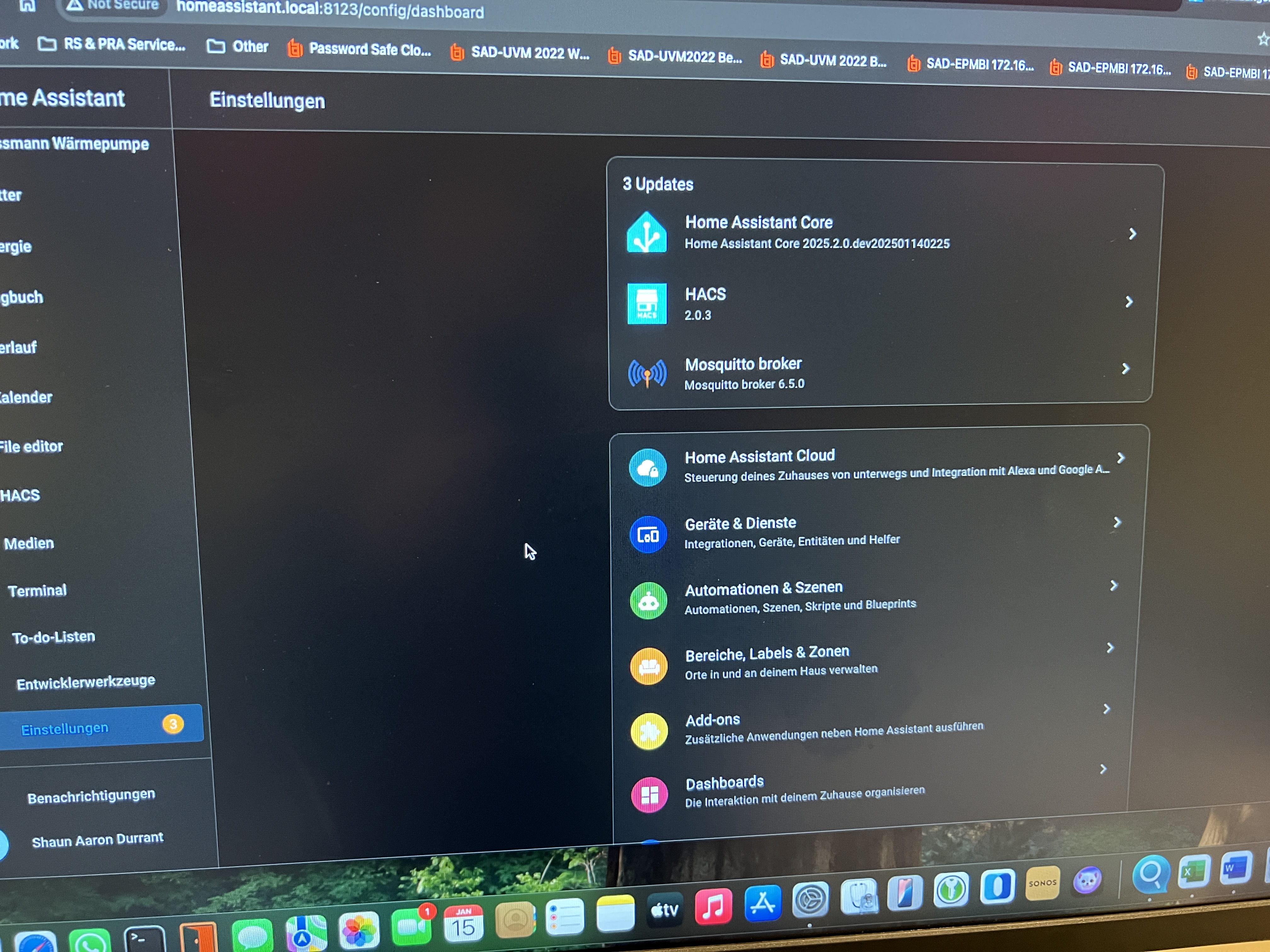

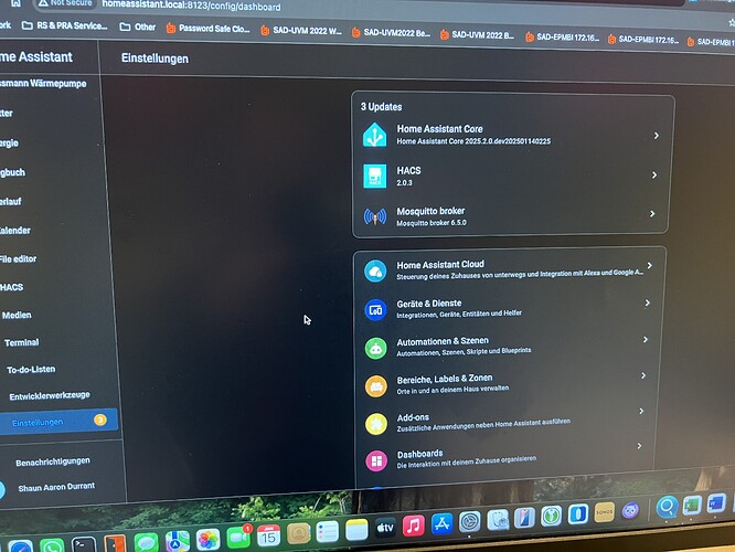

The HAOS on Pi5 Shows following today
Found the following in Supervisor Log
2025-01-15 22:55:54.924 WARNING (MainThread) [supervisor.jobs] ‘Updater.fetch_data’ blocked from execution, no supervisor internet connection
2025-01-15 22:55:54.928 WARNING (MainThread) [supervisor.homeassistant.websocket] Connection is closed
