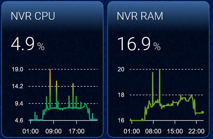

In my case - Beelink EQ12 N100, 16GB RAM, 2 TB SSD works fine.
I’m happy with it.
HA + Frigate (local media storage)
HA with >800 enabled entities, 24 integrations, 30 automations …
Frigate with 5 cams 4Mp, 1 cam 8Mp, 24x7 recording, detection, retention 10/30 days.
Screenshot is a part of the infrastructure dashboard.
My Samsung 970 PRO NVMe™ M.2 SSD 1TB has been running 24x7x365 for 5 years now. There are no problems.
