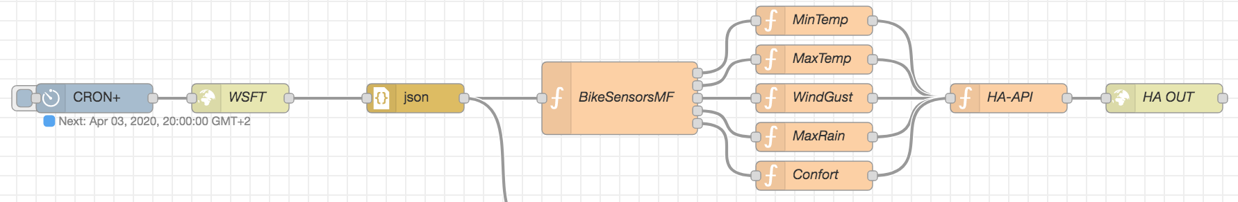

I am using something similar, but, I think more complex. I have defined for my wife and I, we usually cycle to work , what I call a bike comfort index. The idea is to show on lovelace something like this:
Screenshot.04-03-2020-19.40.17
The color of the bike is a combination of min temp, max temp, wind and rain. The values at the 4 corners are the minTemp / maxTemp / rain and max wind.
Getting the values from the weather API up to sending all the results to HA through API is done like this:
The complex part is the javascript in BikeSensorsMF:

I assume all of this is doable in templates. The problem (for me at least) is the debugging part of templates.
I know very little of javascript. And I was able to do this (crappy) code.
So, not perfect, but, I believe easier to code and to debug than templates. At least for me :slight_smile:
GV
Everyone thinks differently. Personally, I hate looking at flowcharts. Takes to long to read what’s going on, I’ll always stick to my templates.
…but the bike comfort index (sensor.bci) is a great idea… :heart_eyes: :heart_eyes: :heart_eyes:
I appreciate that. The absolute fantastic thing with HA is that you can choose what suits you :slight_smile:
I have migrated from another home automation system a bit more than one year ago. At first, I started with templates and it (almost) killed me!
I am reasonably good in IT but not a programmer at heart. HA + node-red is the right fit for me… For me. Not for everyone.
