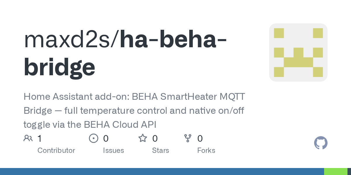

Hey all,
Old topic - but maybe someone will find it usefull.
I was in the same situation with 6 heaters at home - decided to write (viva AI ))) ) the integration through mosquito. All works well for 2 weeks. Happy to share.
