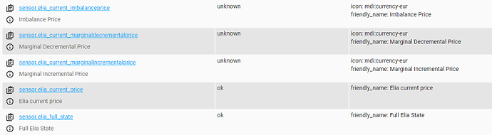

PROBLEM
All is looking good in the “Developper tools > Template”
I can’t get the values (in state) correctly evaluated.
What could be the fix to do so?

this is what I get in the 'States" tab of Developer tools:

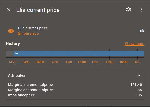

Did you see the mistake, “records” in place of “results”?
yes
still no succes.
tried a lot already
Well, works for me
- platform: rest
  scan_interval: 60
  resource: https://opendata.elia.be/api/explore/v2.1/catalog/datasets/ods161/records?order_by=datetime%20DESC&limit=1
  name: "Elia current price"
  value_template: "{{ 'ok' }}"
  json_attributes_path: "$.results[0]"  # Adjusted to access the first record
  json_attributes:
    - marginalincrementalprice
    - marginaldecrementalprice
    - imbalanceprice
