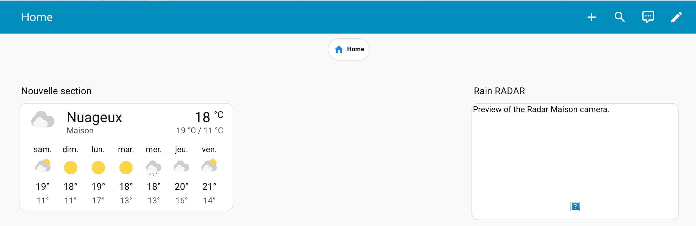

Hello, trying to display a rain radar, mine doesn’t seem to log :
Any idea what the issue could be ?

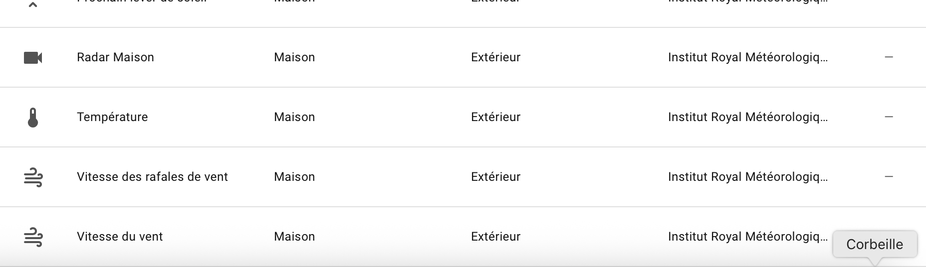

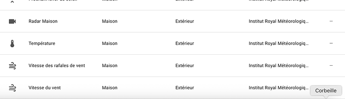

The entities seems to be ok :

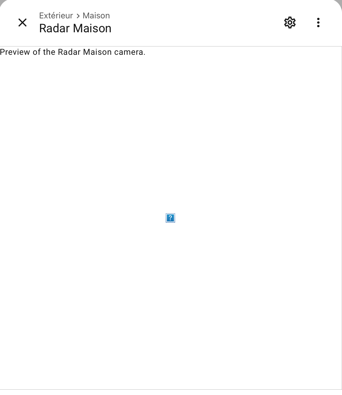

but look like the image is not lading.
so I see this :
and my code :
          - type: heading
            heading: Rain RADAR
            heading_style: title
          - show_state: false
            show_name: false
            camera_view: live
            type: picture-entity
            entity: camera.radar_maison
            camera_image: camera.local_file_2
            image: /config/www/Camera-snapshots/doorbel-snapshot2.jpg
Many Thanks !
Can you pls share your code fir the rain radar part ?
Can’t figure out out to display the “live” view animation …
Many thanks

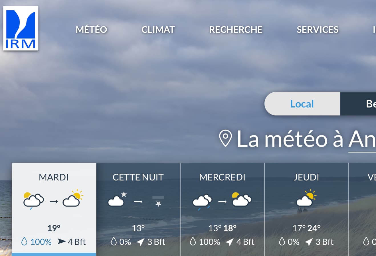

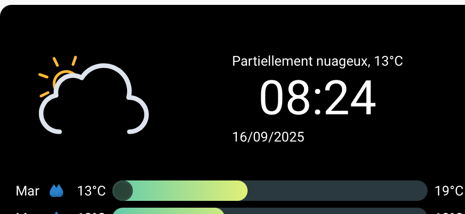

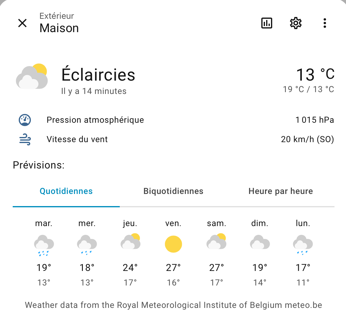

Hello, today the metro in Brussels will not have rain, though the icon shows rain :
      - type: vertical-stack
        cards:
          - type: custom:clock-weather-card
            entity: weather.maison_2
            tap_action:
              action: navigate
              navigation_path: /lenovo-m10-plus-meteo/0
            card_mod:
              style: |
                ha-card {
                  color: white;
                  background: black;
                  border: 0px;
The entity weather.maison_2 is well provided by IRM / KMI but as tou can see shows cloudy in the top, and rain at the bottom …
The KMI website is not talking about any rain son, so where is this wrong information coming from ??
Many Thanks
I can get your confusion about the weather conditions showing here. There are multiple things to keep in mind:
  1. The data is pulled from their app, not the website. It shouldn’t change anything, but sometimes it does.
  2. Home Assistant does not support two weather conditions per day (like you have on the IRM screenshot for Tuesday, tonight, and Wednesday). Therefore, only the first icon is taken into account. This is mentioned in the limitations section on the Github repository.
  3. Home Assistant has a limited number (15) of weather conditions that can be expressed. For example, there is no equivalent of the ‘partly cloudy with a bit of rain’ (like you have for Tuesday on the IRM screenshot). Because of this, I had to map the icons of the IRM to weather conditions supported by Home Assistant. The mapping is shown in a table on the Github repository.
  4. Different cards might show different icons for the same weather condition.
All of those things lead to what you observe. Taking Tuesday’s forecast as an example: Home Assistant only considers the first of the two icons on the IRM website. It maps it to a weather condition supported by Home Assistant (here rainy). Then, each card on your dashboard choose the icon to show. The default card shows clouds with small raindrops for rainy. The custom card at the top probably opted to just show raindrops for rainy.
The same logic applies for Wednesday: the icon is a bit different on the IRM website, but it also maps to rainy weather condition in Home Assistant.
Hope this helps you understand how it works :slight_smile:
