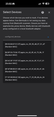

How do I know which one of these is my iphone, so I could start testing? The mac addresses make no sense.
iPhone MAC addresses are randomised for security, so you need to use the Private BLE Device integration to add to Bermuda. See How to get the IRK (Identity Resolving Keys) for iOS, Android etc · agittins/bermuda Wiki · GitHub
There’s also a post here:
Thanks for your reply and help. I managed to add my own iphone and apple watch to the Private BLE Device integration. With the help of my MacBook i managed to get the IRK for the two devices.
Thanks for this tutorial Jack. Seems like I should be able to add my wife’s iphone and kids android devices with this well written arduino totorial. Will test it out later today.

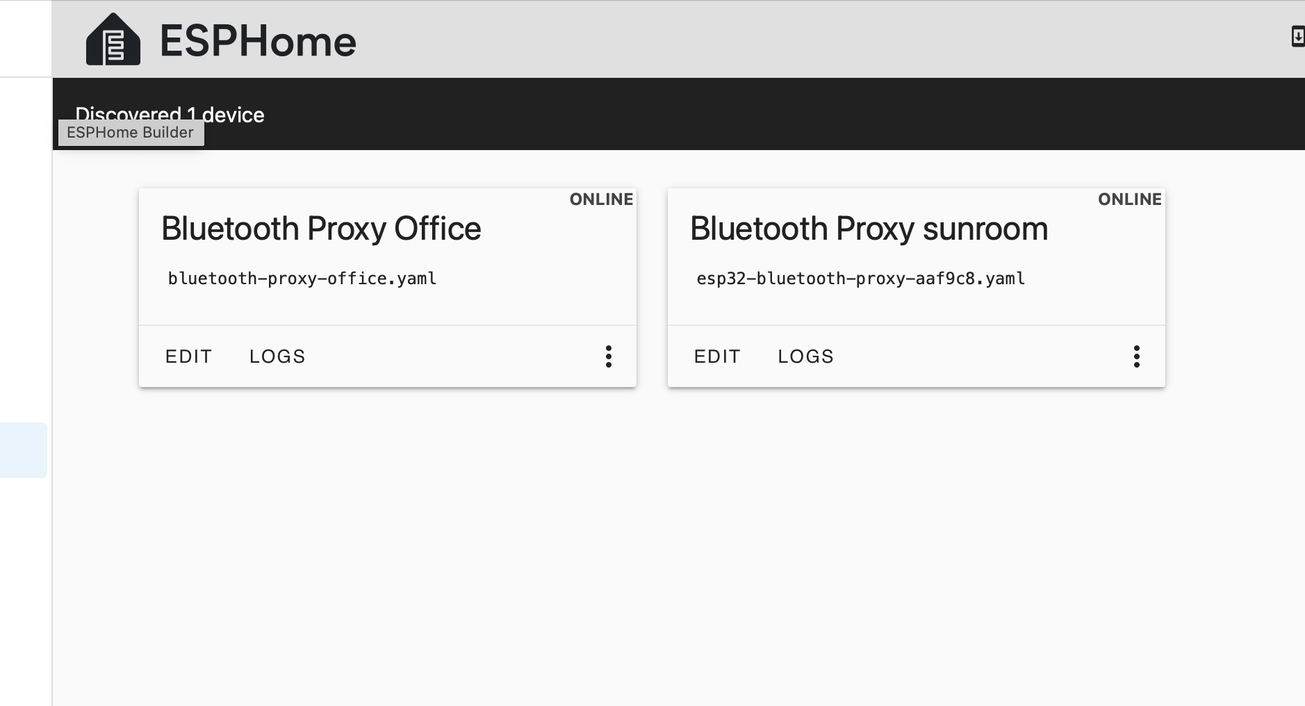

I just installed esp home on a few devices, however the latest one I configured it does not seem to work… I can see it in ESPHome builder, but I am sitting right next to it yet its reporting to the other one that’s 50’ away…
im sitting in my office, the esp device is less then 2’ from me…

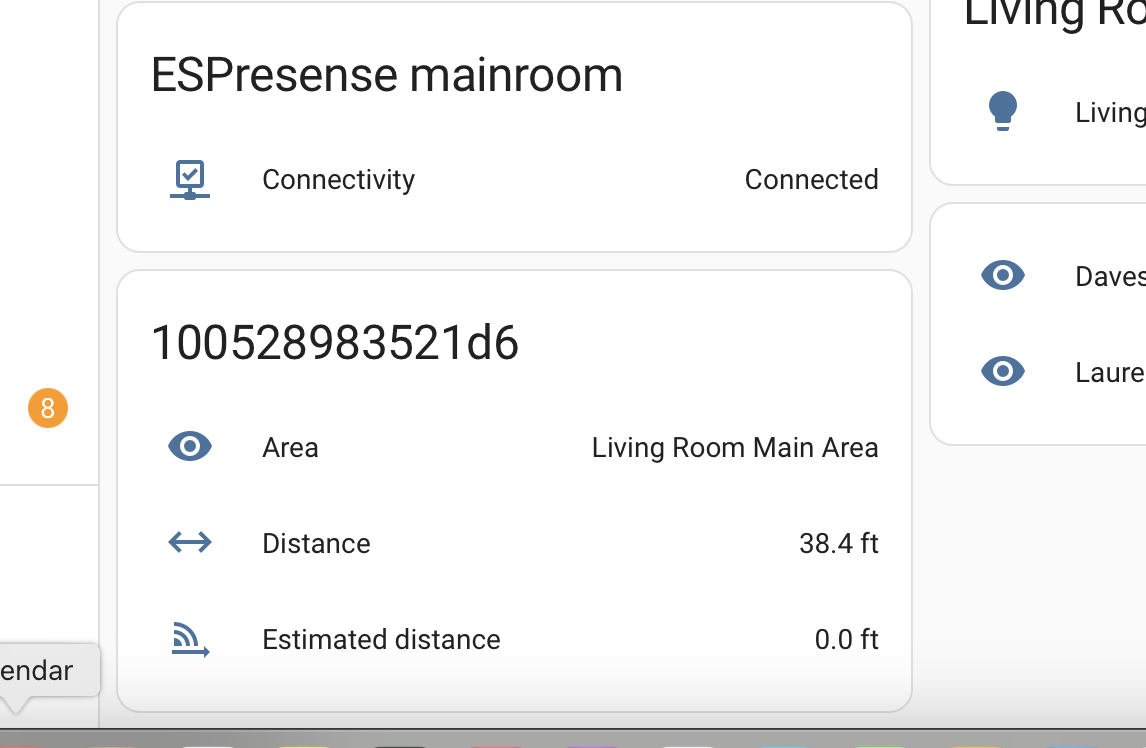

I’ve been running ESPresence for about a year but haven’t done anything with it - because the location tracking indoors is wildly unreliable.
For example, I’ll be sitting still at my desk in my office, with my ESP32 radio within arm’s reach, and my location will bounce to nearby rooms randomly.
This is obviously completely unreliable for automations. :slightly_smiling_face: And you might say, “Just apply a smoothing/average function to it!” Yes, but then there is an increased delay between when I enter a new room, and that room reporting as my “location” in Home Assistant.
I think this is partly due to the complex and outdated configuration page for the ESPresence devices.
I’ve even resorted to listening to the raw MQTT distance messages from all of my radios and attempted to create a template entity which attempts to guess the room I’m in based on those sensors and some sample data I took, but that didn’t really significantly improve the problem.
Does Bermuda make any significant improvements in these areas?
It’s better than espresence for me Jake. But you will still need smoothing. I was able to get it to lock pretty reliably to my most used sensors now im working on extending to true trilat by overlaying BPS and bayeseans like Jack recommended
Hi Jake, if you have a proxy quite close, and the distance ratio to the next proxy is large, and your proxies use my recommended settings, and the device you are tracking transmits reliably, I’d expect tracking to be pretty solid.
And if it isn’t, you can upload a diagnostics to a GitHub issue and i can analyse what’s not working.
The distance ratio is important though, if your proxy is one metre away, and the one in the next room is only 2m away you might find it pretty glitchy.
I can’t advise on how it compares to espresense as such, a number of folk have found it better, but I’m sure there are those who’ve gone back, as well :woman_shrugging:t4:
