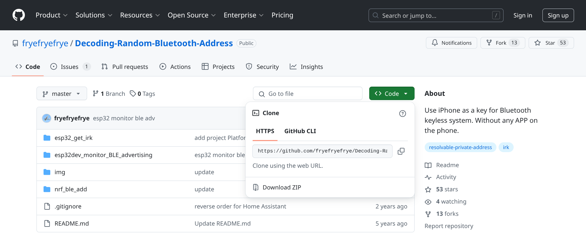

  1. Download the code from Github (click the green “Code” button, then download Zip)
  • Extract the contents of the zip
  • In Arduino IDE - open the extracted esp32_get_irk folder and then open the file esp32_get_irk.ino
