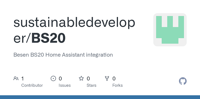

Hi all,
I’ve just bought a BESEN BS20 charger, and I can not used the mqtt stuff. So I made a quick and dirty implementation for the charger (based on the raw communication between the mobile app and the charger).
Now, it has unknown statuses and parameters, that I included as a simple sensor. If somebody can solve what a param means, please notify me on the github page (issues).
I’m not a python developer, so everything is possible. But now I run this integration for days without any problem on my RPI2b based Home Assistant.

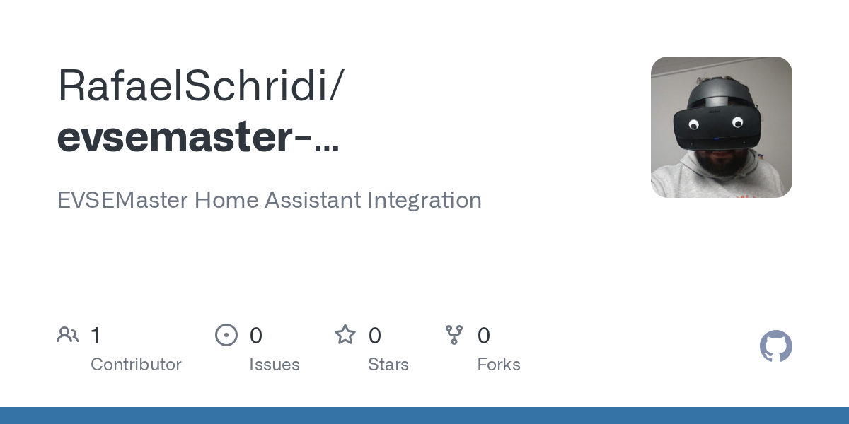

Hello Everyone,
because i’m bad at searching forum i didnt see this topic until now …
So i developped from scratch a similar integration, for my evsemaster compatible charger.
i did my test on a MOREC but i think the protocol is the same
here is the link just in case :
