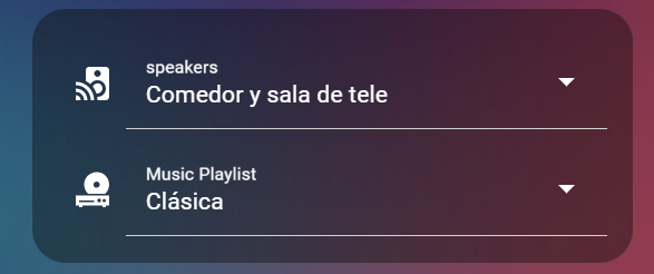

Hi everyone. Im looking for a good audio/music system that allows multiroom that works with Spotify. I currently use Alexas and im familiarized with them. I have a setup where i can choose from a list of playlist that i created, also choose wich group of alexa speakers to use. I created a Spotify Account just for the house.
Im facing 2 main issues. The first one is that it takes several tries to start playing, i have to choose different playlists to start spotify. The second issue is that an specefic Echo Dot is constantly unavilable so if i choose it as a speaker, nothing happens.

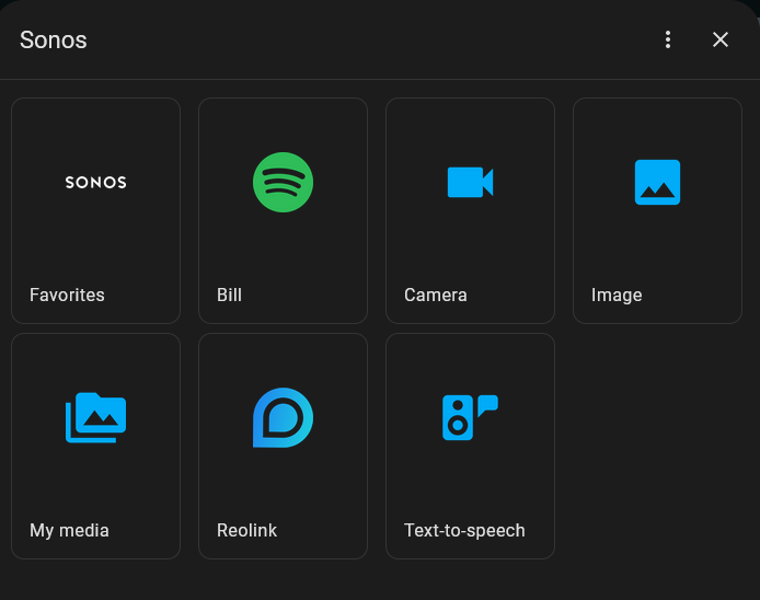

I have six of them and they are all integrated into HA (using the Sonos integration). What do you want to know? :slight_smile:
How well does that integraton work with Spotify, is there any limitation and how do you control the music playing?
Also wich other cheaper speakers integrate well with home assistant?
Spotify is in the media library, so I can play pretty much anything to any speaker. I’ve not had any issues that I can remember.
Not that I know of. Using the Sonos V2 app (separate outside of HA), I can play anything from Spotify, Amazon Music, Apple Music, YouTube, etc). From HA, I can play Spotify and any playlists I have saved in the Sonos app.
I use HA, the Sonos app, Apple Music, Spotify, Alexa, etc… all on different devices (phones, tablets, PCs, voice). All in all, I can control media in the house using pretty much anything. lol
