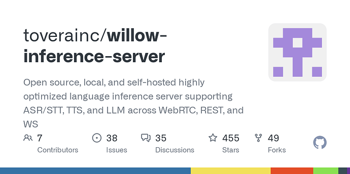

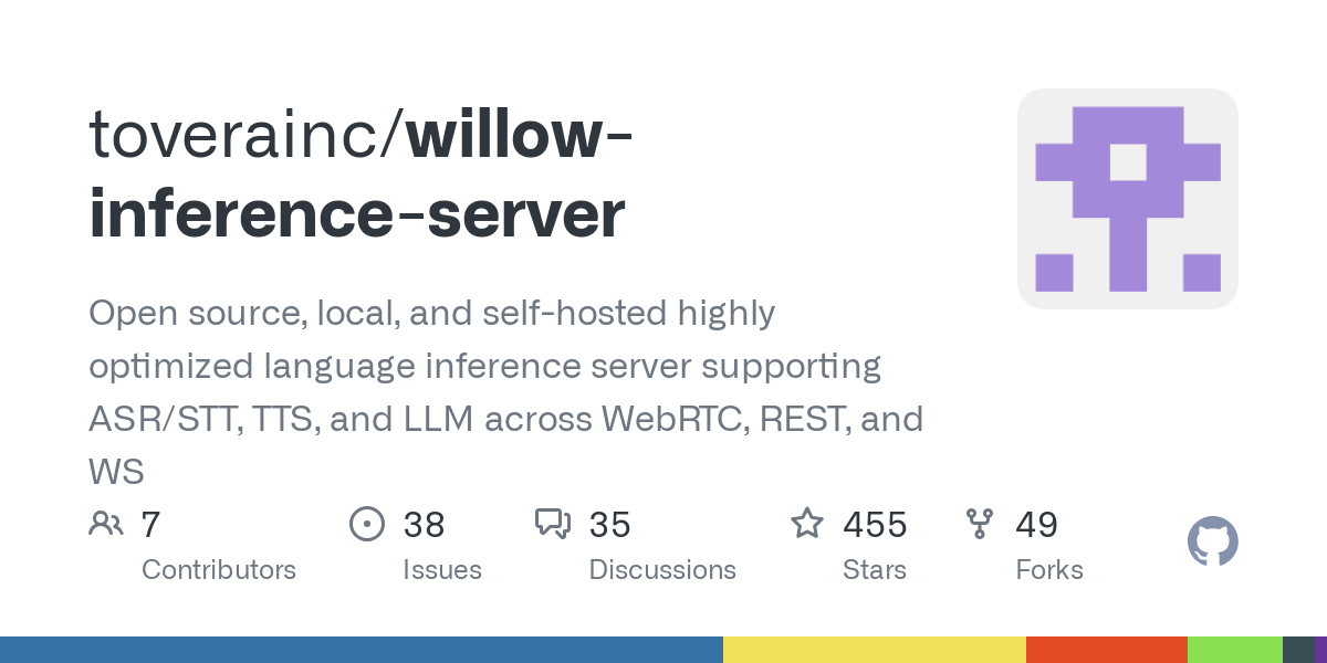

Before any of you go any further, have a look at this:
There is no commercial option. As @sayanova says, to get local TTS you need a high-end graphics card and you’ll probably have to buy a gaming case to put it in. The results are great - comparable to Alexa - but it’s a lot of work and very expensive.
