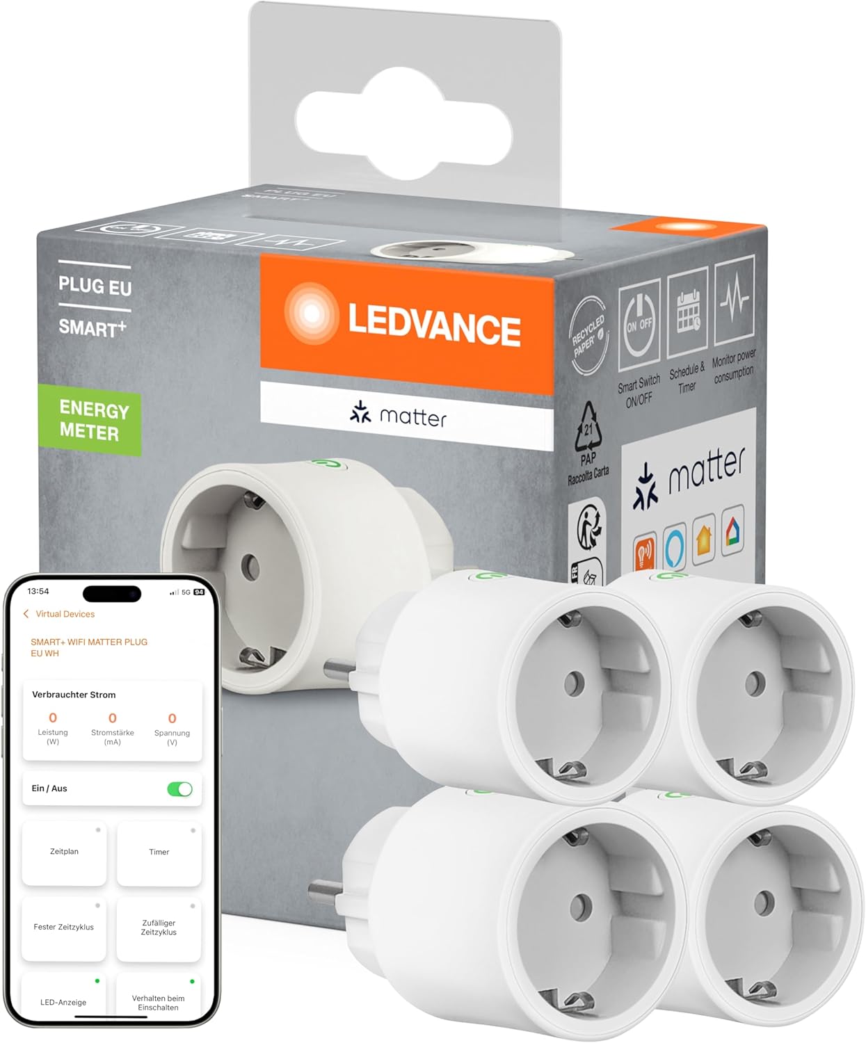

At this point I had success only with one product:
LEDVANCE smart switch (with Matter support):
Note: Be carefull, LEDVANCE has similar version that is not Matter compatible!
The only issue I had with this one is power metering - aka power consumption in kWh was not available out of the box in my HA. I had to create “Helper” sensor to calculate this and now it is working flawlessly.
Everybody is also praising SHELLY’s products, but they are more expensive for the same outcome.
Just my 5 cents so you don’t neet to follow my steps :wink:
