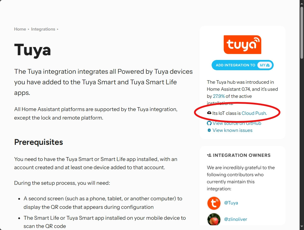

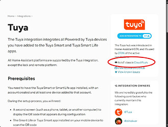

ChatGPT sayes there isn’t an official “Feit” integration available directly in Home Assistant. These plugs typically operate on the Tuya/Smart Life platform, which means HA doesn’t support them out of the box under the “Feit” branding. But also states that You can integrate Feit plugs using the stock Tuya integration in Home Assistant, but it requires linking through their cloud and isn’t ideal for local control.
But I don’t see Tuya or Smart Life listed anywhere on the Feit product page linked above…
Are these an OK choice for using with HA??
Don’t get them.
The official Tuya integration is cloud based. There are a couple third party local integrations, but they are a little more headache to setup.

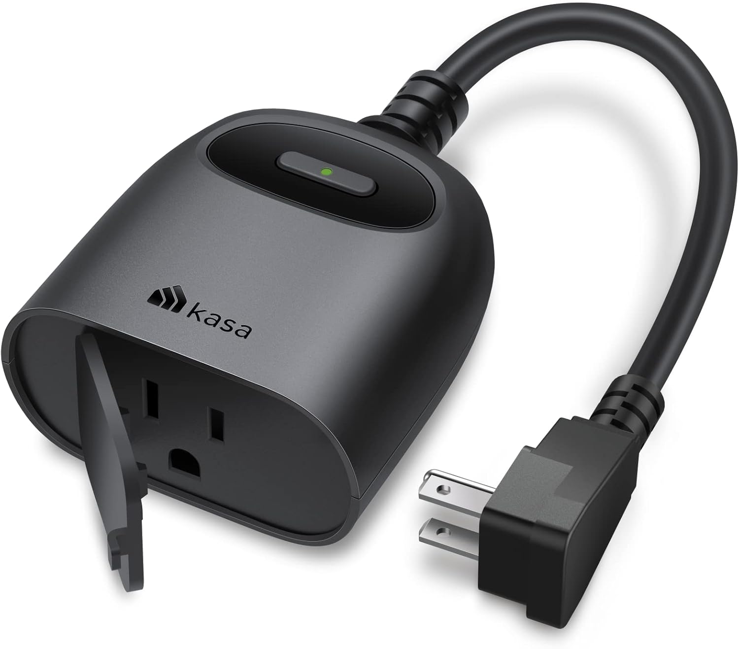

I think I’m going to go with TP-Link Kasa plugs:
Kasa Outdoor Smart Plug, Smart Home Wi-Fi Outlet Timer, Max Load 15A/1875W, IP64 Weather Resistance, Compatible with Alexa, Google Home & SmartThings, No Hub Required, ETL Certified(KP401)
They use Wi-Fi and Matter - and seem to have integrations built into HA. Can anyone agree that these will be a good fit?

I’d verify that those are truly local. My experience with Kasa and TP-Link are that they really, really want to use a cloud server. Like, with firmware updates blocking local access. Maybe things have changed since I last tried them, but I remain skeptical.
Kasa had a “security patch” at one point that shutdown the port for third party access.
They turned back on it after an outcry from home automation users, but whether they learnt from it is hard to say.
I avoid them from then on.

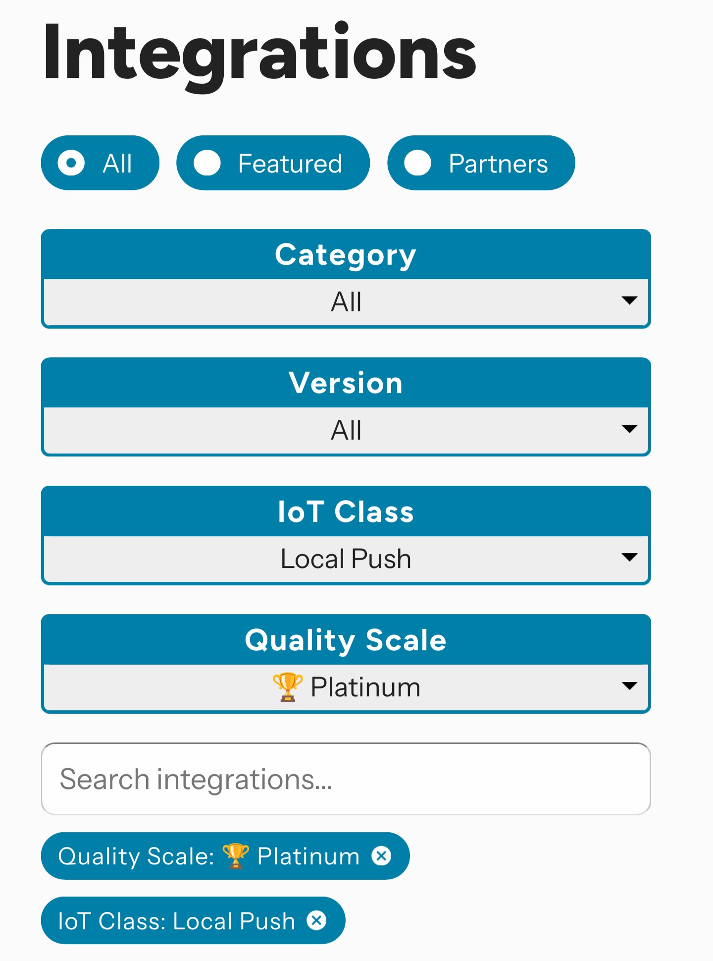

If you seek “best” open the HA integrations page (over 2000 entries this moment) and filter with quality to platinum and iot class to local push :trophy: :rocket:
You will probably end up with some esphome device which doesn’t need a bridge but allows full local control and ownership :star2:

I have used the Kasa outdoor plug for 1 year in HA until the plug finally died from getting too wet. The plug does need an internet connection and does send error messages of going off-line at times. It does seem to recover on its own and come back online. To be perfectly honest, I replaced the Kasa plug with a new Kasa plug. The reason being was that I could not find a descent outdoor plug on Amazon that was Zigbee.
Though when I first started my home automation adventure I started out with KASA/TAPO plugs and switches, I now dislike them because of their constant error reporting and wifi necessity, and have been replacing them slowly with Lutron switches and ThirdReality (Zigbee) plugs. I get zero reported errors from these and they have worked rock-solid. Now if I could get a reliable outdoor zigbee plug, I could rid myself of this Kasa one.
