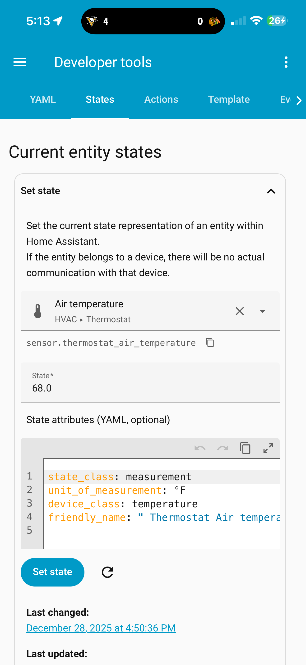

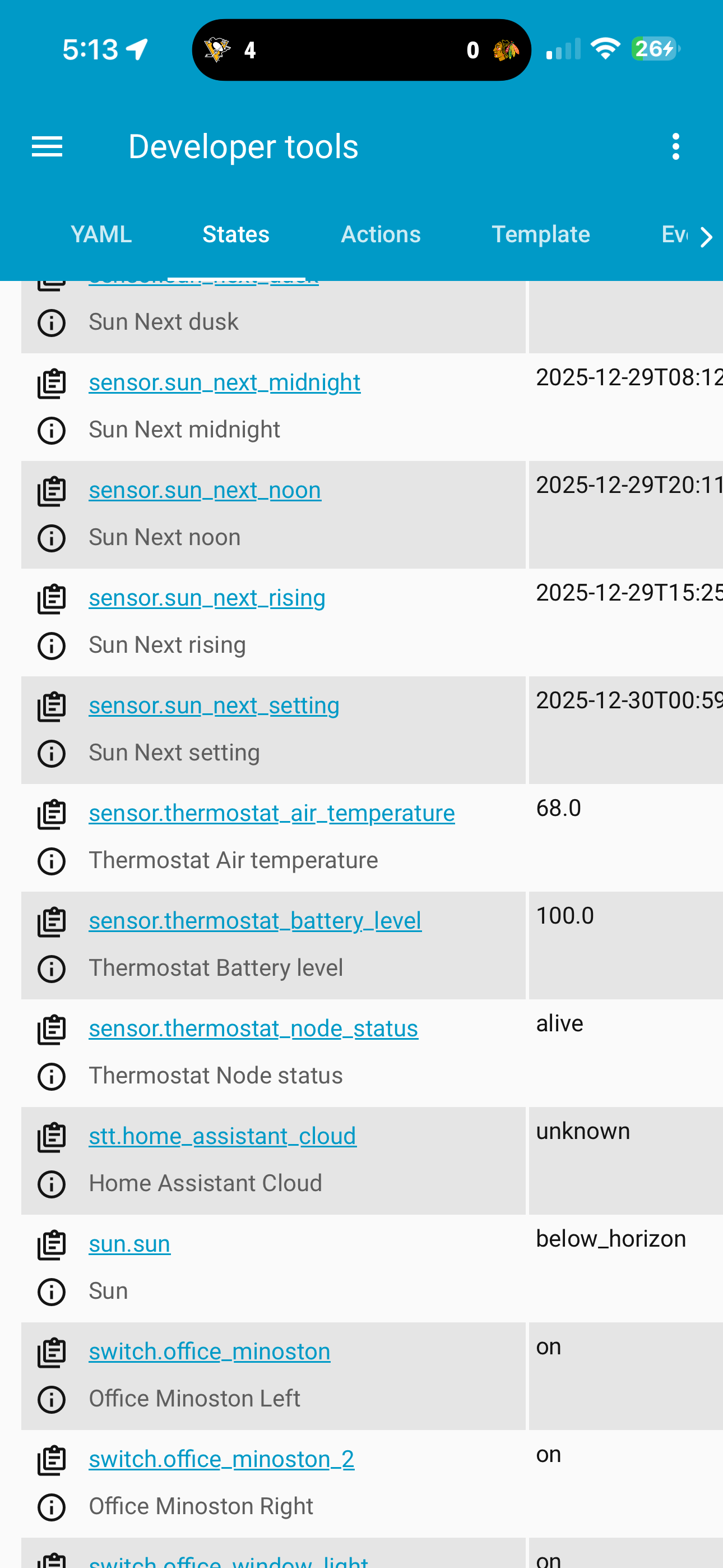

The temperature shown here does not reflect what is on the panel and I cannot get it to change based upon what the panel says nor the state of the hvac such as idle when it’s running.
