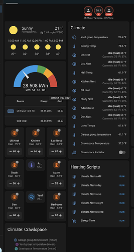

Here's a write up I did on my energy monitoring that allows you to see both high level energy use, use by category, and granular use. Ive been running this for a few years very reliably, but there is some effort in getting it setup.

That’s a reference I intended to return to. I’m green with HA, and it’s been an intense few weeks with it. But yours is a reference I saw, intending to make use of in due time. I just wanted to give a shout of thanks for making the time/effort to share all that.
:+1:
:edit: Your post is likely the deciding element when deciding to go with Emporia.

FAQ at HA Energy Dashboard FAQ · GitHub
Rollup:
Individual data a little further down the same page:
See the demo for a more interactive visualization.
