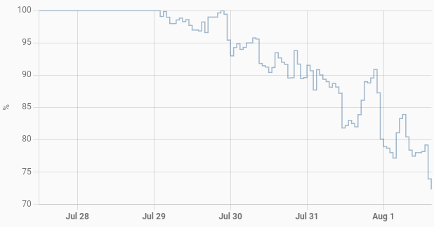

Sounds like li-coin cell type? They can’t output the 3V for long even when full if temperatures drops to much. So they probably only output 2.xV which “tricks” the firmware on the device to report a empty battery while they still are able to deliver some current to keep the device working. :low_battery:
My findings regarding typical Li-coin cell type: They easily (self)discharge around twice as fast in cold(er) environments. Most important the fact that the voltage drops quickly in the beginning, like 0.1V per day resulting in maximum voltage with a full battery to be only around 2.6V after couple of days in the fridge. Depending on the device broadcasting can be come unreliable quite quickly at some certain (low) voltage. :chart_with_downwards_trend:
Example of quick voltage drop in cold (still positive) environment with a full coin cell li-type battery :point_down:
