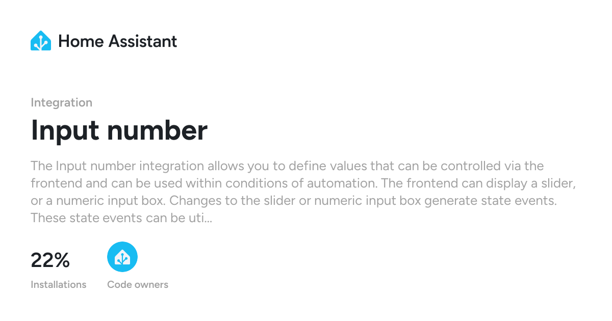

Automations can turn on/off the fan based on if it humidity goes below/above desired level. You would need to set that level based on an input number entity. That number can be decremented each hour by calling the service decrement.
The thing I need help figuring out is how to script out an automation that will slowly lower the humidity setpoint 1% per hour over 48 hours. This decrement service possibly sounds like what I'm looking for but I don't know how to use it.
Use an automation with a time based trigger for every hour and decrement the input number that is used to set the humidity.

Your starting point:
A bit of reading involved.
Thanks, that looks like what I need for sure!
