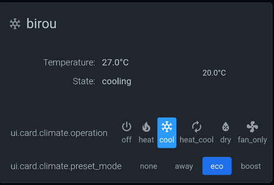

Hello all,
Is there a way to have a card for AC control that looks like this (or better)
Currently the card looks like this and it is very ugly and I don’t know why there is that text there instead of buttons or something.
I can get to the first picture if I click on the snowflake in the top left corner.
Cheers!
Lucian
Looks like you are using a custom card, maybe this one:
A different take on the thermostat card for Home Assistant ♨️
instead of the built in one:

Or you can use this custom card. This will display exactly the more-info screen.
🔹 Display the more-info dialog of any entity as a lovelace card

wow this is awesome! I wish I could mark both answers as solutions! I am now using the new Thermostat card and it does what I want but I will be using your suggestion too for the zigbee lightbulbs!
Never noticed before but the current temperature is at the top of the card on the more info and inside the ring in the dashboard card
