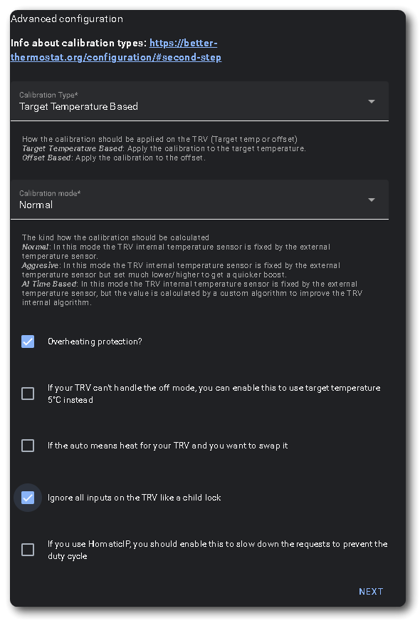

My Steps:
the Result, also i turned Debug on
Tried this several times but won’t work, also no debug entrys, HA updated today
