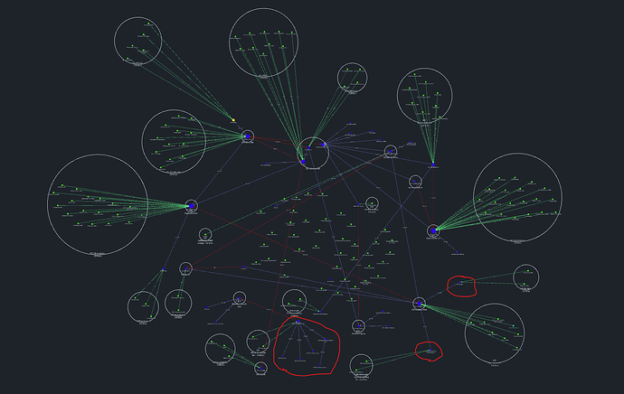

Thing is that in the Middle of the building there is basically nothing but routers to bridge the distance. Strange thing is that some devices seem to use routers that are very far away instead of the ones directly next to them
edit: This is the network. Red are the S1-Rs
