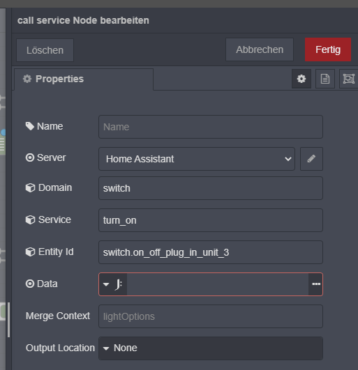

try today my first steeps with nodered…
have problems to use the Bigtimer. Perhaps anyone can help:
i know there are easier ways, but i will do this with the bigtimer (and learn how it works)
what is the question? or what is the problem you are trying to solve?
a- i need help with the correct settings
i want switch my lamp on and off (on 8:00 off: 9:00)
b- what is the diffent between output 2 & 3 ?
i thought the both fired the same signal? output 2 one time, and output 3 a loop.
but it seems, the output signals are different.
so wire the output to number either 2 or 4. if you use number 2, then set the correct Msg box.
/* if you checked the “repeat output” box, this will send the message every minute actually. So as per your setup, every minute between 8am and 9 am it will send “on” and after that “off” until 8 am in the morning. uncheck the repeat output box, if you just want 2 messages (i.e one at 8 am and another at 9 am.)
