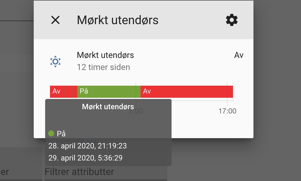

What does the binary_sensor’s history show for last night?
I know this might not help your original issue, but using a template without using data_template:
still feels incorrect (though using the notify service, this seems to be ‘overlooked’…)
use:
- service: notify.adults
data_template:
title: 'Home Assistant'
message: 'Det er lyst ute, kl. {{now().strftime("%H:%M")}}'
palengh
(Pål Engh)
April 28, 2020, 2:27pm
11
The binary_sensor.dark_outside
reported off
for the last 24 hours. Av
is Off
value_template: >-
{{ states('sensor.pir_utetrapp_luminance')|float < 50 }}
The binary_sensor.dark_inside
reported on
between 20:36 and 06:52, which seems reasonable På
is On
value_template: >-
{{ states('sensor.pir_utetrapp_luminance')|float < 150 }}

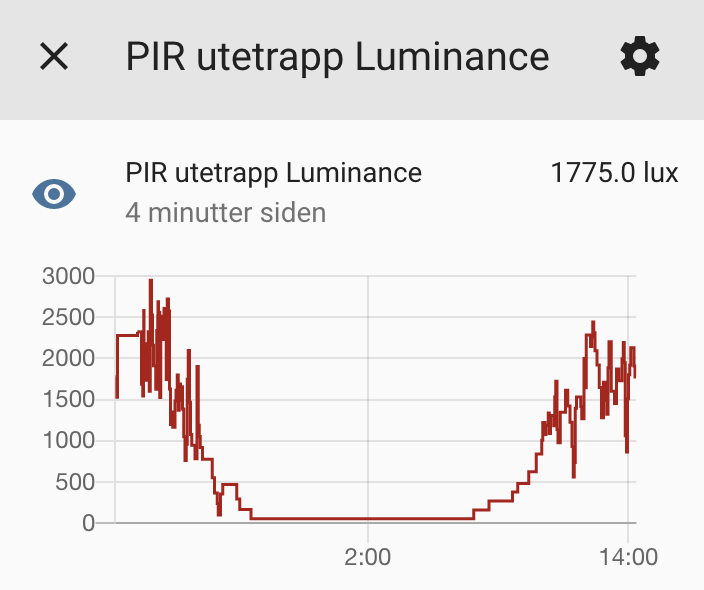

The two dark sensors uses different thresholds for reporting darkness (50 and 150).
The one using a threshold of 150 reports correctly but the one using 50 does not. Can you confirm that the luminance value really does fall below 50 during the night? The scale of the graph you posted makes it difficult to see that.
palengh
(Pål Engh)
April 28, 2020, 2:49pm
14

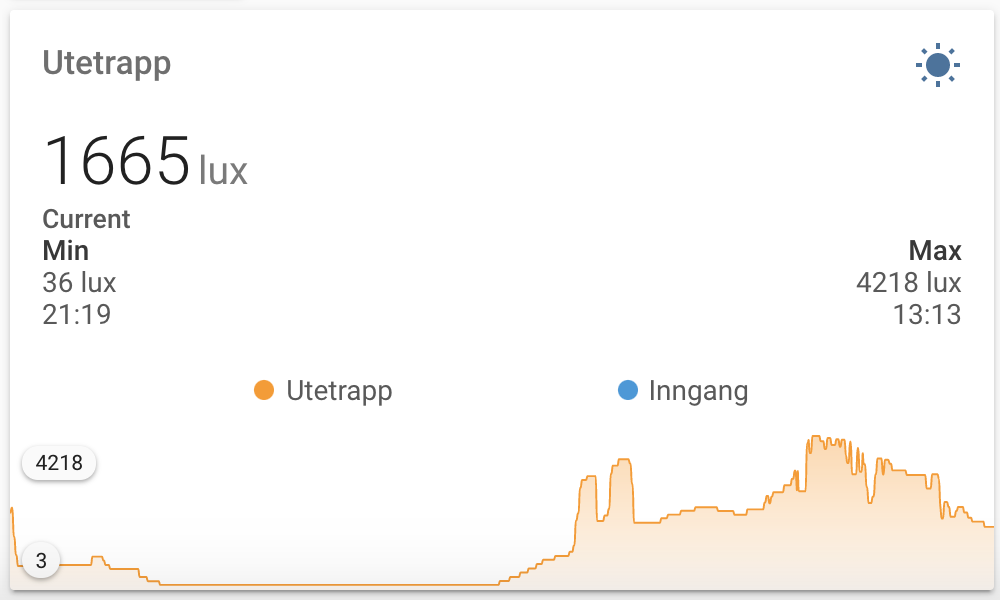

palengh
(Pål Engh)
April 28, 2020, 2:54pm
15
There you go!
It seems to stop at 55
But still I need this to turn the exterior lights on when the light is around 50
123
(Taras)
April 28, 2020, 2:59pm
16
palengh:
If it stops at 55 then that explains why the Template Binary Sensor never reports on
(because it uses a threshold of 50).
Change the threshold value to 60.

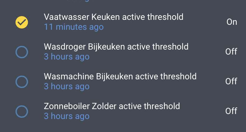

in your case, a look at the binary_sensor threshold might be useful. you can set an upper and lower threshold, and a window to that threshold.
minimum config in your case
binary_sensor:
- platform: threshold
entity_id: sensor.pir_utetrapp_luminance
lower: 50
I use these for my appliances. they’re always on, so on/off is not of interest, but the power consumption checks to see if they are at work:
very nice and very trustworthy (of course, only if the base sensor is)

Did increasing the threshold to 60 fix the problem?
palengh
(Pål Engh)
April 29, 2020, 3:50pm
20
I am not sure if that made the trick, or if the main problem was the sensor was not reporting correctly the night before. Last night the luminance dropped to 36 lux, first time at 21:19.
As you can see the sensor.pir_utetrapp_luminance
(Utetrapp) sensor set the binary_sensor.dark_outside
correctly last night, as opposed to the night before (earlier post/screen dump).
I guess the scripts and automations are working now.
Thank you for your help on this guys
