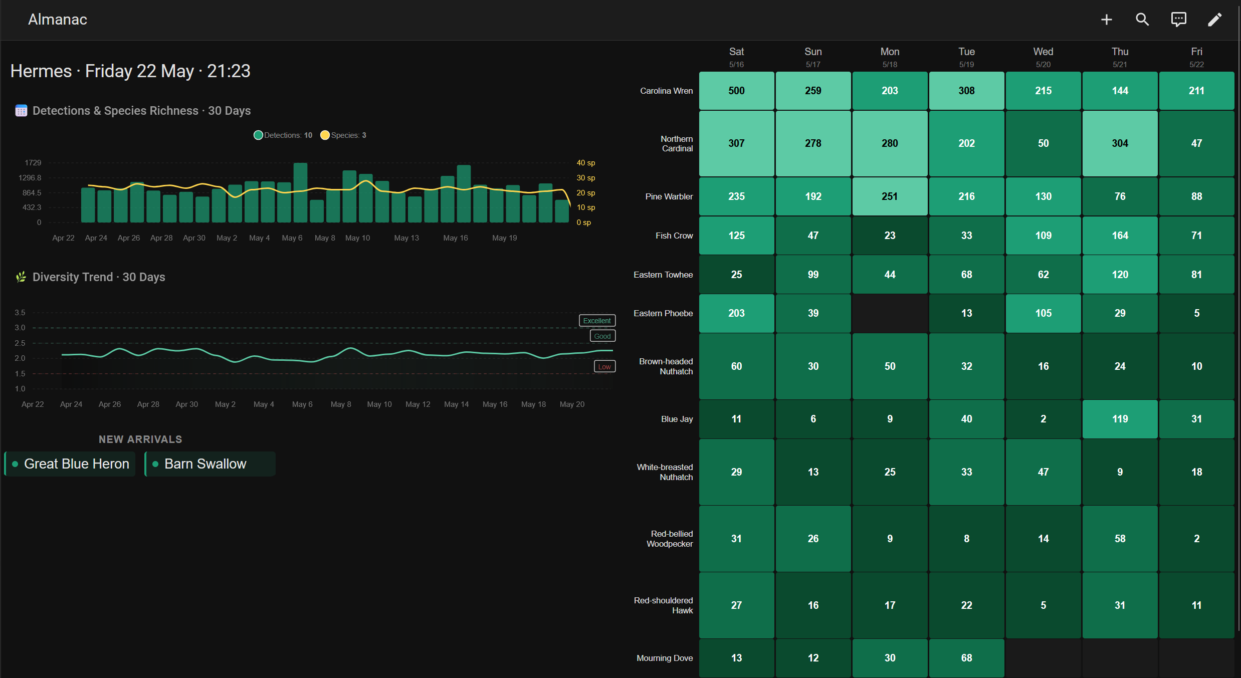

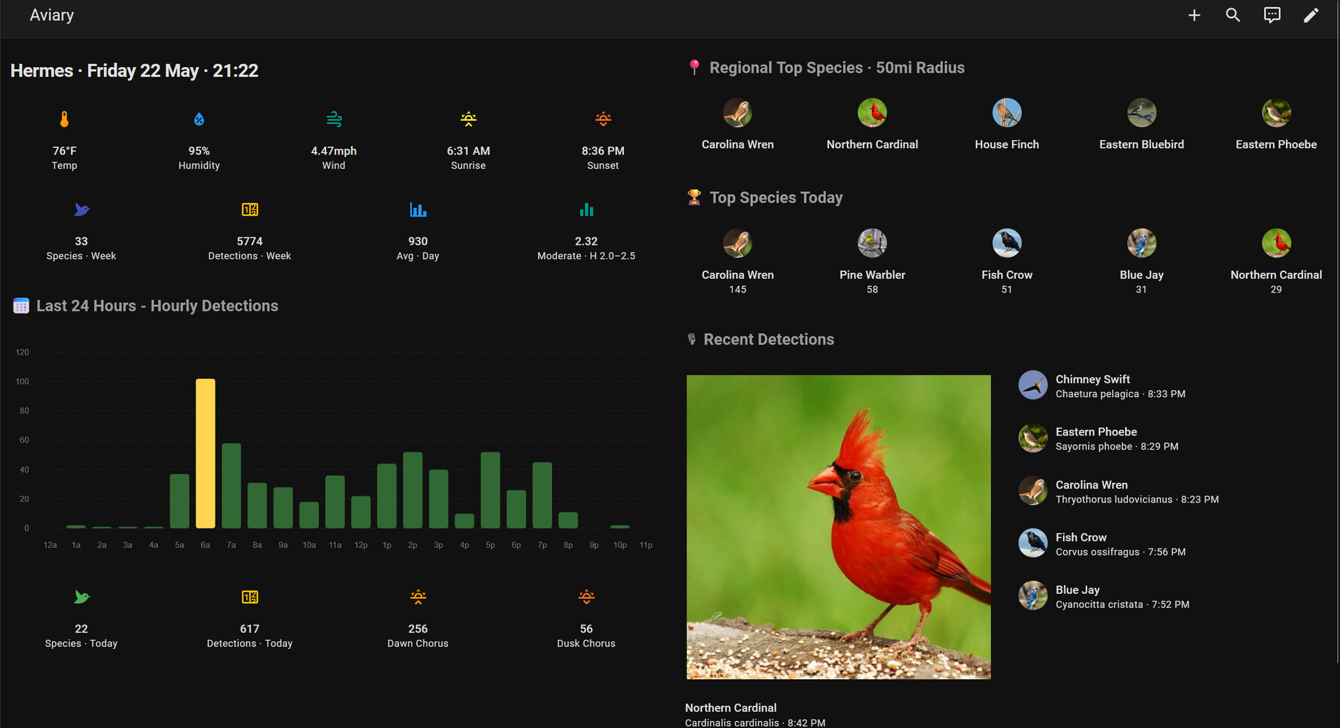

Wanted to share my dashboards for my BirdWeather PUC, that I call Hermes. This is an amazing device that allows you to "easily connect your PUC to your home WiFi, and it will continuously monitor the sounds in your backyard, identifying bird songs in real-time." Even better, the device has an open API that allows you to pull the data in and visualize in a dashboard.
BirdWeather site: https://www.birdweather.com/
BirdWeather API docs: BirdWeather API
I have created two dashboards so far for a Fire HD10 tablet. One is a daily view of bird activity and the second is an Almanac view showing weekly data trends of bird species.
I will include the sensor config and pastebin links for both dashboards to help any new users expedite their birding journey. I am not a professional developer, so any errors or mistakes, my bad.
In the sensor.config, I have noted the specific paramaters you will need to update with your station specific info like API, Station ID, Lat, Long, Timezone, etc. You can obtain the API Token and Station ID from the Advanced Settings in the BirdWeather App.
Please feel free to ask any questions. I can't promise I can answer them, but I hope this helps anyone enjoy the amazing world of birds right outside your door!
Prerequisite cards for my dashboards to work: custom:mushroom-title-card, custom:mushroom-template-card, custom:apexcharts-card, custom:button-card, and card-mod
Daily - title: ðŸŠķ Aviaryviews: - title: Aviary path: birdweather icon: mdi - Pastebin.com
Almanac - title: 📖 Almanacviews: - title: Almanac path: birdweather-almanac - Pastebin.com
