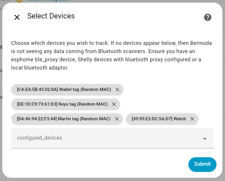

I was under the impression that tile trackers dont support ibeacons and have random mac addresses, at least this is what claude and chatgpt say. Is it wrong? Thank you
This is confusing. They show up in Bermuda as random mac, but it tracks them with no problems (whereas it doesn’t track my phone, for example, without an IRK). All I can say is, they work.

Sorry I’m late I have a Tile wallet and keys and they work. I forgot how I found them, I know I had to activate in the tile app and maybe it showed the address. I remember that they were a tad frustrating but I didn’t use the detector app but in Bermuda it was labeled correct.
