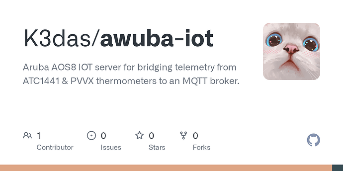

Didn’t realize that there was already work done on this, but I recently wrote a similar tool that parses ATC1441 and PVVX broadcasts, then duplicates and publishes them to MQTT. This supports home assistant discovery and requires minimal configuration to run alongside home assistant in Docker.
In the future I’m looking at implementing more sensors, but I’m largely implementing this based on my own needs.
