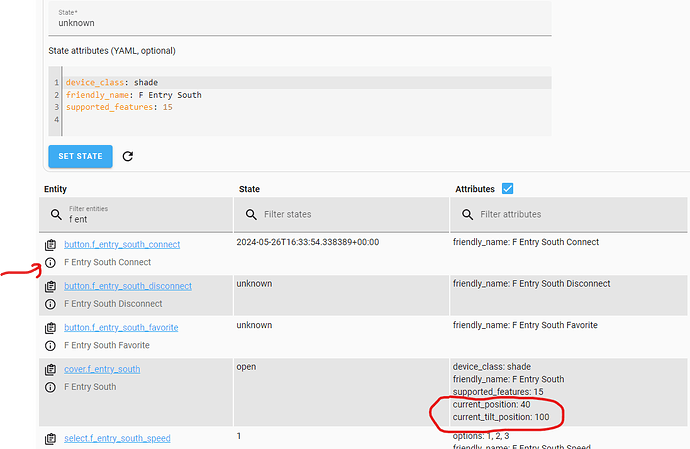

When I go to the developer tools and view states for these 5 different things, I can see the following
For the cover.f_entry_south there are supported features: 15
When I click on the entity to connect sometimes it changes and shows this (the blind was open 40%)
