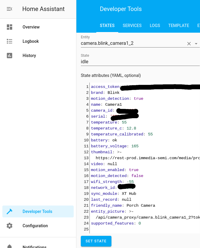

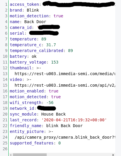

  4. What is the motion_enabled attribute of the camera set to (this can be found by going to Developer Tools > States and then finding your camera. See below for an example entry. Make sure you see all of the same entries that I see, but note that the values will be different.)
  1. Home Assistant 0.108.6
  2. 3 Outdoor cameras. 1 XT in a Sync module and 2 XT2 on a different sync module
  3. Nothing related to Blink
  4. This is just for one of the cameras. Looks pretty much the same
Ok, glad to see all the variables are there.
The fact that you don’t have any errors related to blink and that the motion_enabled variable exists with the camera is quite baffling and, unfortunately, makes this nearly impossible to debug (since I cannot recreate this behavior). But we can try a few things:

I found something interesting that may or may not be the issue. I commented out Blink from the configuration.yaml and rebooted. Once it came back up I restored the Blink settings in the configuration file and rebooted again. After rebooting I checked the state attributes and I noticed that the motion_enabled was true but the motion_detected was false but when I checked the binary it’s still the same as before (see pictures). I’m not sure if it means anything.
blink_state
binary_blink
