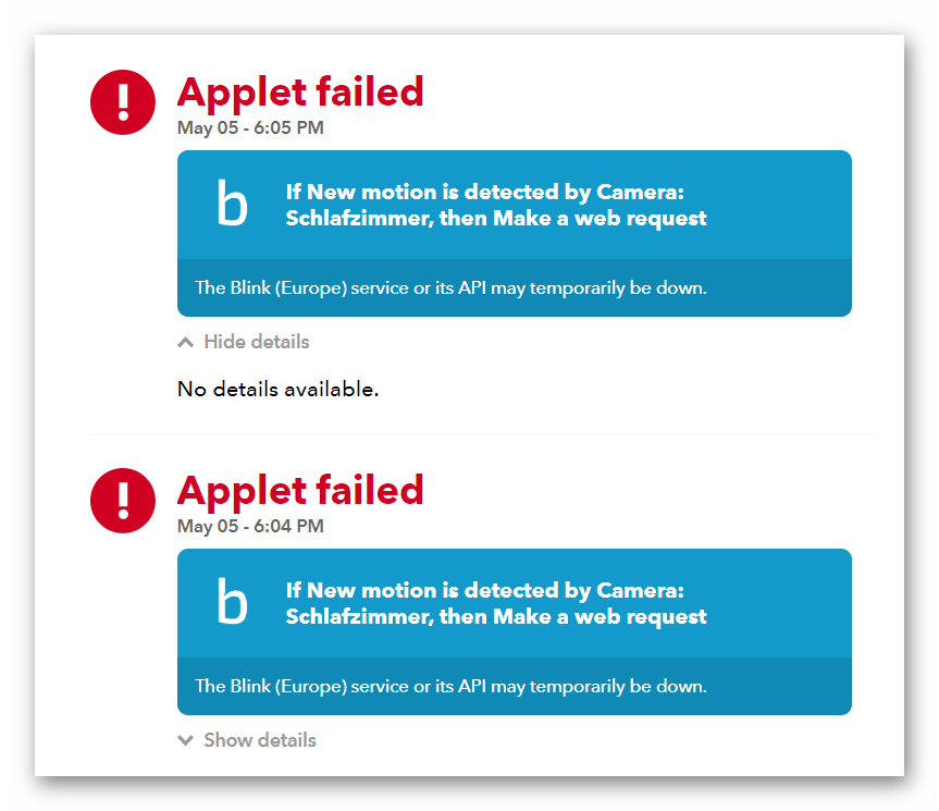

I am currently trying to implement the blink stuff to IFTTT. Has anyone run into the same issue?

Can you arm via iftt or does it give the same message?
It would be ironic if their “approved” method had broken…
