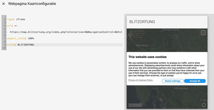

that would be awesome, but that exact line still shows me
what is the rest of your card config? I have it in a fold-entity-row, but imagine that wouldn’t cause the cookie warning to trickle trough …
This is the whole card code:
type: iframe
url: >-
  https://map.blitzortung.org/index.php?interactive=0&NavigationControl=0&FullScreenControl=0&Cookies=0&InfoDiv=0&MenuButtonDiv=1&ScaleControl=1&LinksCheckboxChecked=1&LinksRangeValue=10&MapStyle=0&MapStyleRangeValue=0&Advertisment=0/#6.5/46/15
aspect_ratio: 100%
title: BLITZORTUNG
As I understand it, the Cookies=0 should disable the cookie warning.

haha heck no it does not work; check this card editor with your 100% code:
I struggled with getting rid of the cookie dialog in iframe as well and was never successful, so went a route that uses external web scrape to accept the cookies and then capture an image of the map. Kind of hillbilly tech, however it has been working without issues for months. Perhaps this code will give you some ideas. Good hunting!

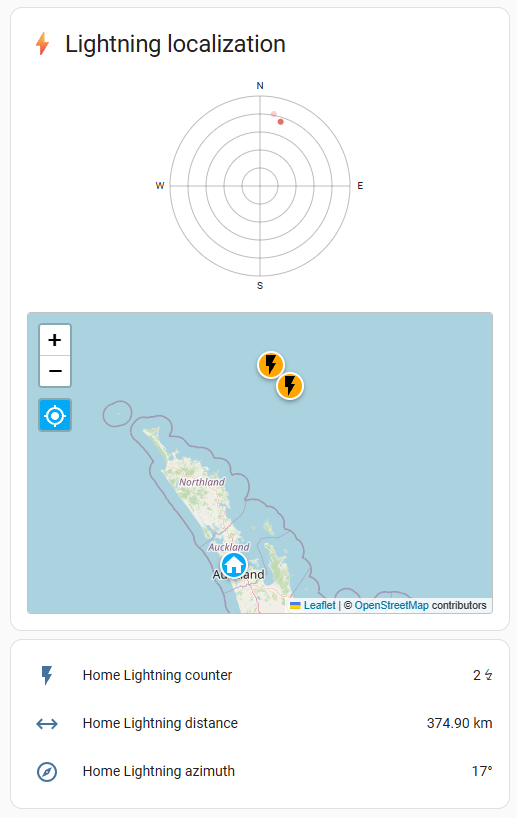

Hey everyone,
I recently published version 1.3.1 of my custom Lovelace card for visualizing Blitzortung lightning data in Home Assistant. I wanted to share it here because it now includes built‑in support for mapping lightning strikes, which fits nicely with this thread’s focus :rocket:
:zap: What it does
This Lovelace card combines key lightning data from the Blitzortung integration into one clear dashboard. It supports:
  • Strike count
  • Distance to the nearest strike
  • Direction via real‑time compass
  • A fading radar chart of recent strike directions
  • A history chart of strike activity over time
  • An optional interactive map view displaying recent strikes relative to your zone.home (requires geo_location.lightning_strike_* entities)
Map View Features
  • Toggleable via show_map: true
  • Plots strikes over the same timeframe as the radar chart
  • Auto‑zoom initially to include all strikes; supports manual pan/zoom with a recenter button
  • Animated markers indicate new strikes
  • Respects your card theme with map_theme_mode (light/dark/auto)
Installation (via HACS)
  1. Open HACS → Frontend → Explore & Add Repositories
  2. Search for ā€œBlitzortung Lightning Cardā€ and install it
  3. Add the card to your Lovelace dashboard using the visual editor
  4. Enable geo_location entities in the Blitzortung integration options for map support
Example YAML Configuration
type: custom:blitzortung-lightning-card
title: ⚔ Lightning Nearby
distance: sensor.blitzortung_lightning_distance
counter: sensor.blitzortung_lightning_counter
azimuth: sensor.blitzortung_lightning_azimuth
radar_max_distance: 100
radar_period: 30m
show_map: true
map_theme_mode: auto
show_history_chart: true
history_chart_period: 1h
Why it matters in this thread
This thread is all about displaying lightning on a map — the map view is now a built‑in feature of this card, making it easy to see recent strikes at a glance, track their locations, and interact with them directly in your dashboard.
Always happy to hear feedback or feature ideas — let me know how it works with your setup!
Happy automating :zap:

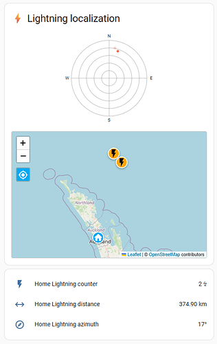

can you explain the top 2 ā€˜radar’ like images?
Asking because I just use an auto-entities to show the strikes on the map if nearer than 25 km, so I wouldn’t need your CCard for that.
The 2 radar images seem rather cool though, Id love to check what you did there
You referring to these images?
They do reset after a couple of hours, to only show the 3 entities acting like a auto-entity card almost
