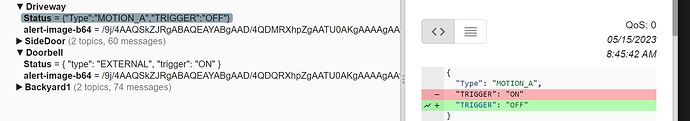

I’m attempting to use the Blue Iris HACS integration but having issues. I’ve installed the integration, configured it ( can see the newly created devices and entities. Using the picture card I can get an image/video of each of my cams. I’ve configured blue iris MQTT connection and alerts for motion. I can view the MQTT messages via MQTT Explorer. But for some reason, I cannot get HA to recognize the the motion events. I’ve had the integration for days now and i have 0 motion events in HA. I dont know how to determine if the issue is with HA or blue iris.

Thats exactly what I have. I read that MQTT is case sensitive so I made sure even cases were done exactly the same. I will say, my 3 reolink cameras trigger as MOTION_A and my reolink doorbell currently triggers as EXTERNAL and yes, thats the output of the &TYPE macro. But none of the 4 cameras even twitch in HA history. I had thought that the type would matter as far as the integration to “link” the TYPE to the “state” but I dont dont know what the expected TYPEs should be for the integration.
So if you look at your MQTT broker you should see something like the following. If you do that is good. It means that BI is reporting to MQTT. The case does matter.

I’m assuming you are working with the doorbell. The case on the drive way is wrong, trigger is upper case and type is capitalized. The key’s should all be lower case like on your doorbell.

Well aint that embarrassing. I totally payed attention to the topic but completely ignored the payload. Much appreciated. I’ve got the doorbell working (its still on my desk) but I’ll check on the installed cams later.
