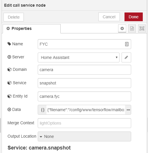

You could do something similar to my other thread. Instead you’d just use a Call Service node like this:
The Data section has this:
{"filename":"/config/www/tensorflow/mailbox_fyc.jpg"}
I then use that to send it via a Pushover alert. The flow sends a snapshot of my front yard cam if anyone opens the mailbox.
