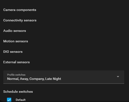

Sorry to piggyback on this threat, but I had Blue Iris & HA working with MQTT, but it’s now all screwed up and I’m not sure what I did (if anything).
For unrelated reasons, I did a system settings restore on BI. I also renamed a camera, so I went back in the HA BI integration to make sure the motion binary sensors were adopted, and now the only items with a menu are the BI “Profile switches” (i.e. Schedules, see screenshot).
I deleted the entire integration, rebooted, and started over, but no joy.

I fixed my issue of not being able to adopt most of the Blue Iris entities, but not sure why it worked. I changed my Blue Iris login to the same credential as I have in HA for MQTT. The permissions were the same as the prior user, so who knows, but it’s working now.
