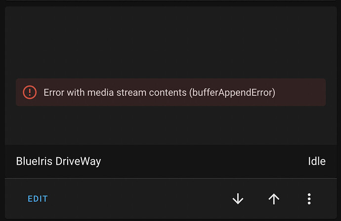

Hoping someone can help me. I use Blue Iris for my cameras and i am looking to add them to a Lovelace card but have the card show the live video feed not a 10 second picture snapshot.
I have installed the Blue Iris integration via HACS and i have configured this. I see the entities etc. I have used a picture glance card and set it up as per below.
If i leave the camera view as Auto then i just see snapshot every 10 seconds. If i set it to Live then i see nothing just a black card with the error
Error with media stream contents (bufferAppendError)
I am a little unsure as to how to resolve? is there a better card or setup to get my Blue Iris cards to show?
type: picture-entity
entity: camera.blueiris_driveway
show_state: true
show_name: true

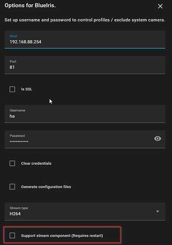

Mine kept doing this after I checked “Support stream component (Requires restart)” check box on the Integration setup. I unchecked and restarted the component and no longer get this error.
