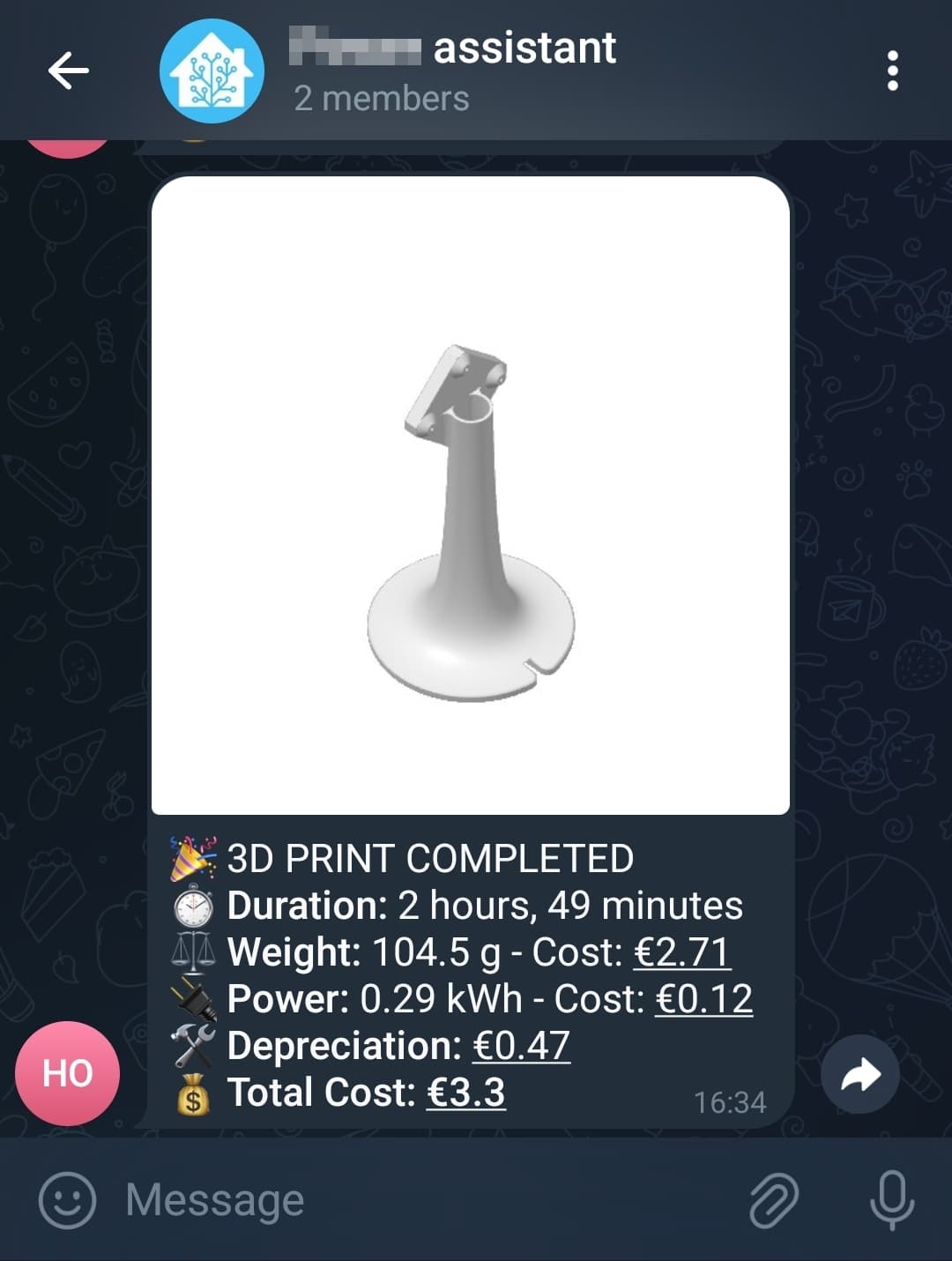

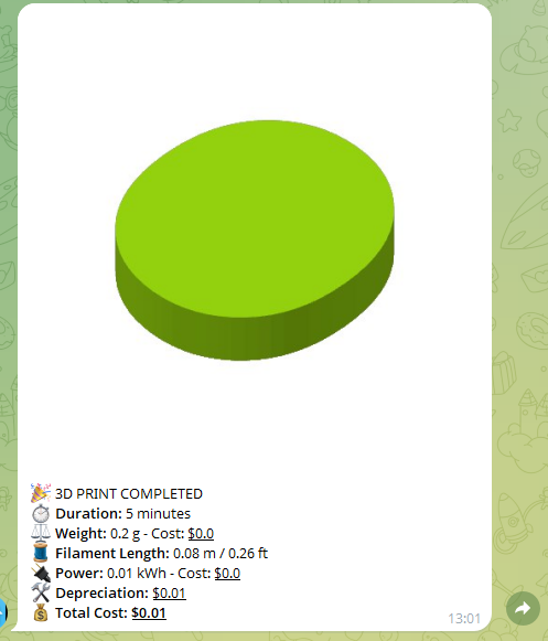

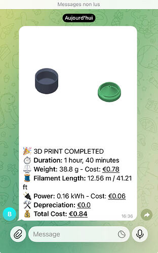

Example message
🎉 3D PRINT COMPLETED
⏱️ Duration: 2 hours, 48 minutes
⚖️ Weight: 92.0 g – Cost: €2.39
🔌 Power: 0.31 kWh – Cost: €0.12
🛠️ Depreciation: €0.41
💰 Total Cost: €2.92
(“Filament Length” line appears only if you supply a length sensor.)

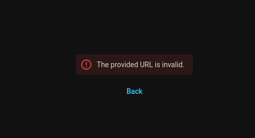

Doesnt seem to work on my Instance. I have several issues:
1.I get Error while executing automation See log:
automation.auto_bambu_cost_notification: Failed to load URL: 404
i tried my publicly accessible https://Adress and then i tried
http://internalip.adress.of.ha:8123 and still get the issue and i wont get smarter when i watch the traces.

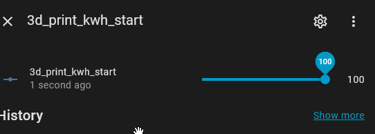

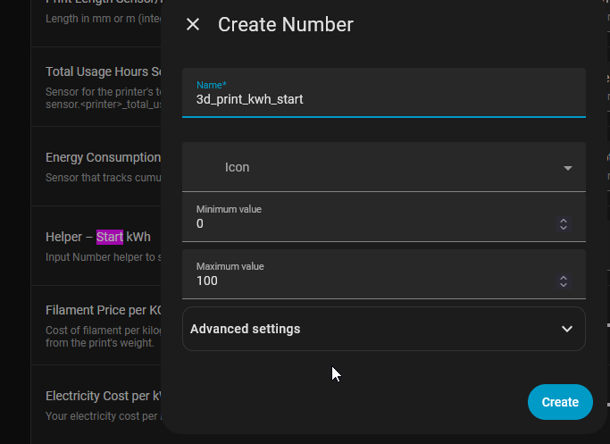

and second issue: It wants me to create a helper but i think this helper doesnt make sense, wouldnt a text helper make more sence since
Now i can have 0 to 100 - but that wont help, wont a input text make generally make more sense?!

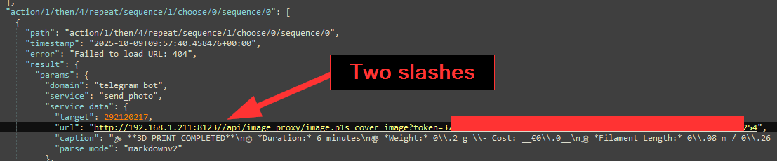

I found out that sending without a picture works totally fine
So i was trying to find out why the picture push didnt work and why the message does not get sent at all.
for some reason it uses a wrongly formatted URL (thats why I get error 404) with two slashes, even though my _ha_url variable is totally fine and explicitly defined in the trace log:
      "changed_variables": {
        "_ha_url": "http://192.168.1.211:8123",
BUT it seems to add two slashes “//” to it instead of one in the trace log.
After that I changed the url to http://192.168.1.211:8123/" for the lulz (despite what the blueprint tells me) and voila: triple slashes.
It seems to be that the blueprint is flawed in line 446
url: '{{ _ha_url }}/{{ cover_image_url }}'
since the cover_image_url already has a “/” in the beginning
I went into the dir of the code (\config\blueprints\automation\soflane) of it, made a copy and removed the excess slash so the var gets glued together correctly to:
url: '{{ _ha_url }}{{ cover_image_url }}'
then i copied the yaml into \config\blueprints\automation and now it works as a quick fix…
and it works now.
I just created a pull-request for removing that excess character

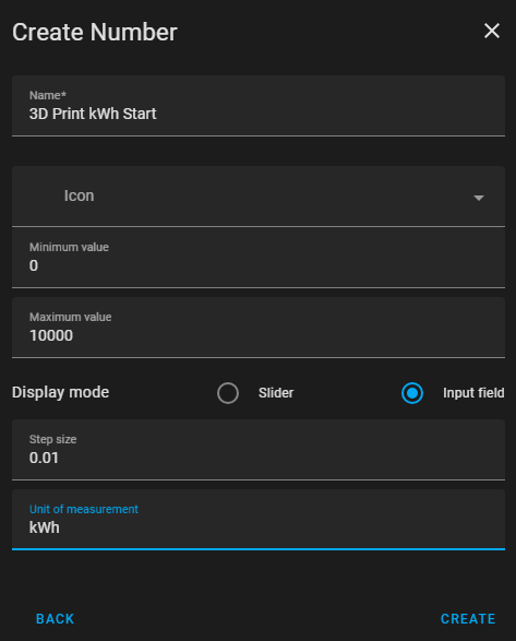

  • About the helper type (“Start kWh”): It must be an input_number, not a text helper — the blueprint performs arithmetic with it. The default 0–100 range you see is just Home Assistant’s default when creating a number helper. Feel free to set a wide range and small step, depending on your smart plug’s precision. For example:
    • Min: 0
    • Max: 100000
    • Step: 0.001
    • Mode: Box

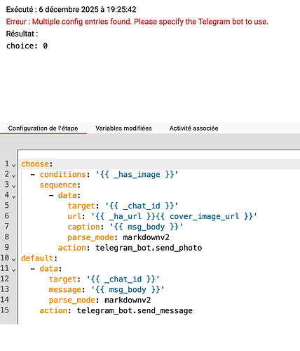

Hello, I’ve managed to configure everything except for sending the message via Telegram, which isn’t working. I’m entering my ID (numbers) but the message isn’t being sent. When I test it using the developer tools, it works.
Do you have any logs to share ?
Sorry, It was me who made a mistake. With the / :grimacing:
I downloaded it again from GitHub and everything is fine, thank you!

Hello, I added a bot to HA for Alarmo. I created discussion groups for ease of use. However, it no longer works with blueprints. I correctly specified the group ID with the hyphen (-) in front. Here’s what I see in the automation logs.
did you ever figure this out? im running into the same log message.
Hey, not the author at all but do you have a target set. It looks like it’s one of the inputs, it needs a target that is a telegram bot.
The issue is there because it has the "old" telegram send message scheme which now breaks the whole script from what I see.
It worked flawlessly but after an update it broke this blueprint/automation
The whole Blueprint needs an overhaul.
@yannouche4260 @Lx4lights512
I have created a quick fix for the new format.
I tried to change as little as possible in the blueprint since I am not super experienced with blueprints but I wanted to make sure it works as longterm as possible for the upcoming 2026.9.0 update.
Basically what I did:
  • removed chat.id var, since the whole splitting etc is no longer needed basically
  • adjusted to using notify entities AND you can also specify multiple targets
  • refactored cosmetics with AI
  entity_id:
    - notify.telegram_bot_1234567890_1234567890
instead of the old
    - 1234567890
This is the current yaml....i will soon try to fork and request a merge
