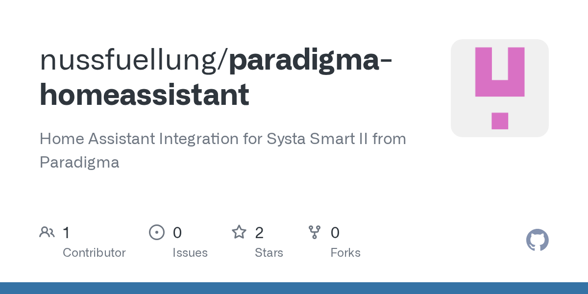

Exactly what is your issue? What are you creating again?
Would using something like this help?

Hey make sure to take a look at my new Integration, it may help you. I’m also in contat with the engineers from Ritter to make an update as soon as the new Modbus Update ist published.
nice work, @nussfuellung !
are you aware of this modbus documentation from paradigma?
It’s from 2023 but from what i’ve tried in regards of my marin-series heatpump it seems to be accurate.
https://dam.ritter-energie.de/pinaccess/pinaccess.do?pinCode=KJx68pzqFP39
if you need someone to test the heat pump integration, just let me know
Got it installed but still cannot connect to unit. I think its related to my systacomfort beeing hardware version 1. Software 1.34 (latest) with the old 2 row LCD.
just noticed, that you have already implemeted everything that is being shared via modbus in their v1.1 doc and you are just waiting for the update on their modbus implementation.
Any ideas, by when the will publish the update?
Q2 - 2026 thats the information i got from ritter
