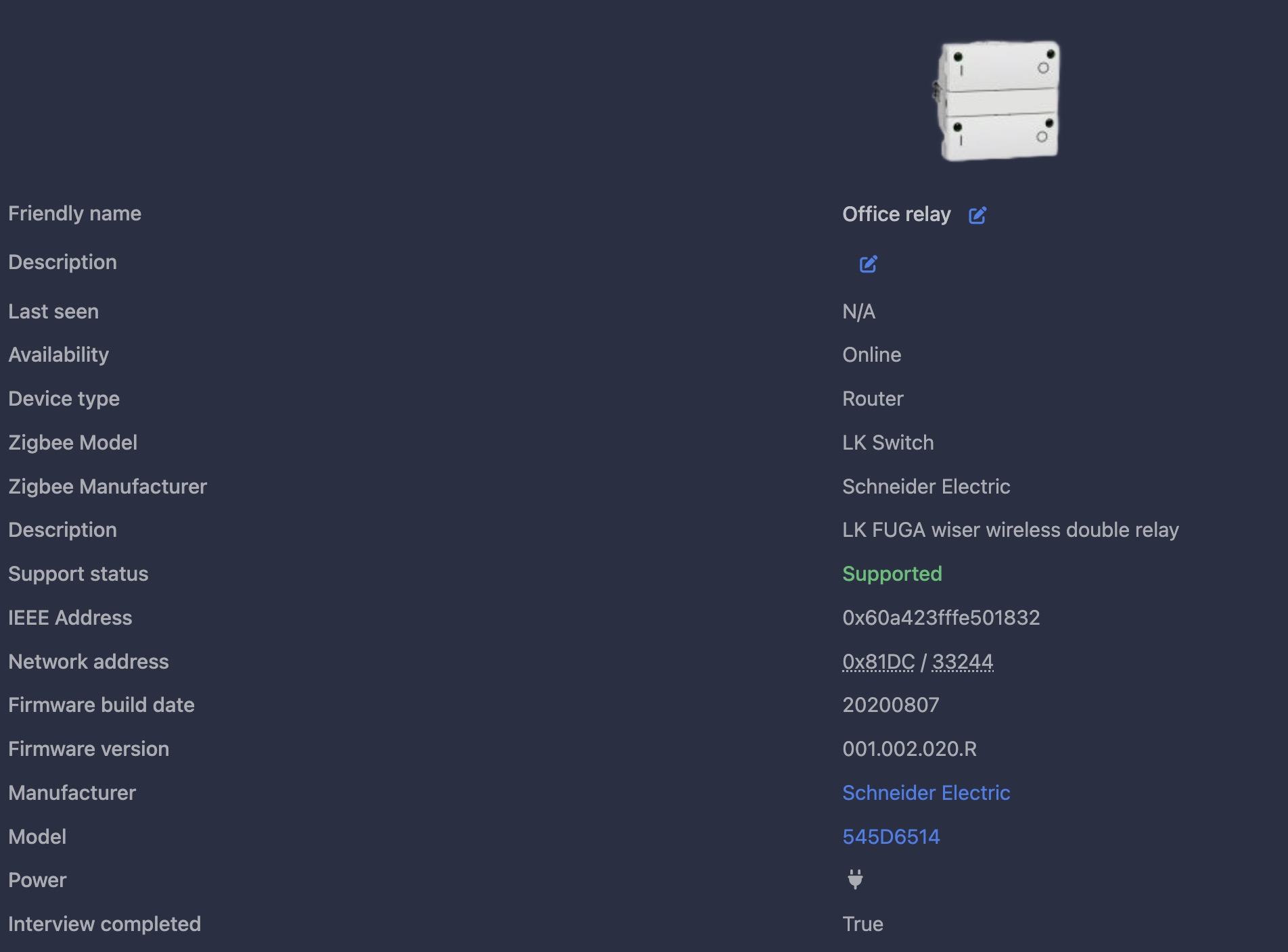

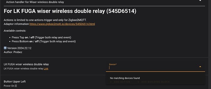

I’ve installed the relay this weekend and it’s linked via zigbee2mqtt but I have some issues using the blueprint.
It’s not selectable as a known device.
Attached some screens to explain it better.
What firmware does your device run, mine looks super old.
Mads
Same here, not shown, i have few of them and also the dimmer version, none show up.
I have fixed it, the filter had to be slightly changed :
