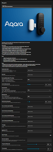

Preview

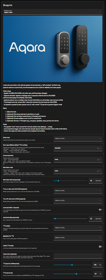

Locks
1) Locks
  • Auto-lock after the door reports closed (delay slider) with “re-open” cancellation and final re-check.
  • Announcements for LOCKED/UNLOCKED (lock)—only after confirmed state changes.
  • Optional reminders while door lock UNLOCKED, repeating every X seconds until resolved.
  • Speech is queued (no overlap), with a small TTS pre-roll to prevent clipped words.
Mode: queued (max 2) — prevents overlapping TTS when multiple messages fire.

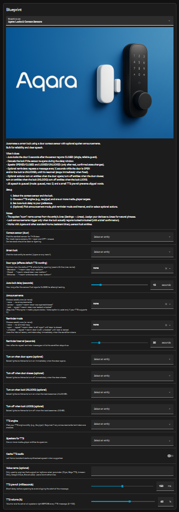

Locks & Contact Sensors
2) Locks & Contact Sensors
  • Announcements for OPENED/CLOSED (sensor) and LOCKED/UNLOCKED (lock)—only after confirmed state changes.
  • Optional reminders while door OPEN or lock UNLOCKED, repeating every X seconds until resolved.
  • Optional action on OPEN: turn on chosen lights/switches.

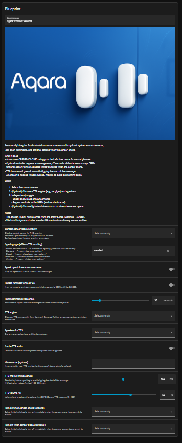

Contact Sensors
3) Contact Sensors
  • OPENED/CLOSED announcements using the entity’s Area name for natural phrases.
  • Optional “still open” reminder every X seconds until the sensor closes.
  • Optional action on OPEN: turn on selected lights/switches.
  • Clean queueing and TTS pre-roll for reliable, non-clipped speech.
Mode: queued (max 2).

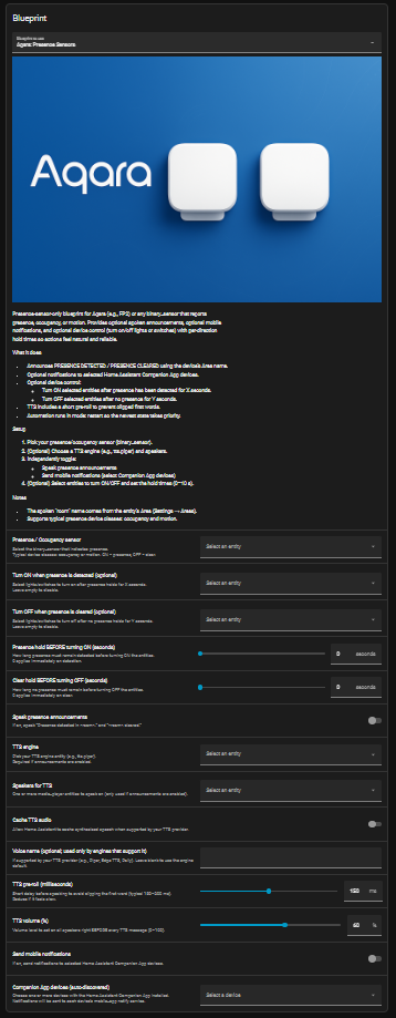

Presence Sensors
4) Presence Sensors)
  • Announces “Presence detected in .” and “ cleared.”
  • Optional mobile notifications to selected Home Assistant Companion App devices.
  • Device control: turn ON after presence holds X seconds; turn OFF after clear holds Y seconds (0 = instant).
  • TTS pre-roll for clean speech; actions are fast, holds configurable.
Mode: restart — the newest presence state wins immediately.

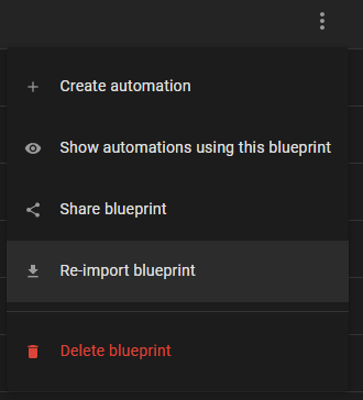

New: a dedicated Lock-Only blueprint joins the pack! Plus crisp TTS, smarter reminders, faster device control, and UI polish across the board.
PLEASE RE-IMPORT ALL BLUEPRINTS, THO THEY WERE NICE BEFORE I REMOVED ALL ERRORS AND THEY ARE NOW FANTASTIC!

:window: Aqara: Contact Sensors
  • Turn OFF on close (new) to pair with the existing “turn ON on open”.
  • Added TTS volume control; OPEN/CLOSE TTS uses area-based phrasing with pre-roll.
  • Open reminder repeats at your interval and stops instantly on close.
  • Inputs clarified; retains queued mode (max 2) for neat audio sequencing.

:lock: Aqara: Locks (NEW)
  • Time-based auto-lock (works without a contact sensor).
  • Announcements for LOCKED/UNLOCKED only (no transitional spam).
  • TTS volume control + pre-roll for clear speech.
  • Optional actions on lock state: turn on when UNLOCKED, turn off when LOCKED.
  • Matches the UI/logic style of the pack for a seamless experience.

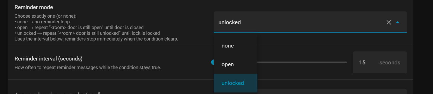

Door & Locks
Not sure if anyone caught this but if you have Reminders set to unlocked in the Aqara: Doors & Locks Blueprint the lock never auto locks which was an unintentional yet smart feature. You don’t need a reminder to lock a door that locks it self, however i still plan to change this because i didn’t code it with the intention for it to behave this way but the blueprint runs makes it behave that way:
Why it happens (exactly):
  • The unlocked reminder starts on the lock_changed → unlocked trigger and then runs a repeat while the lock is unlocked (it waits, speaks, waits, speaks…).
  • The automation is in mode: queued. A run that’s doing the reminder loop never finishes until the lock becomes locked.
  • When you close the door, the sensor_closed branch (the one that calls lock.lock after the delay) starts a new run but because we’re in queued mode, that run waits behind the still-running reminder loop.
  • Result: the auto-lock call never executes until you manually lock (which ends the reminder run). So it looks like auto-lock is disabled whenever “unlocked” reminders are on.
