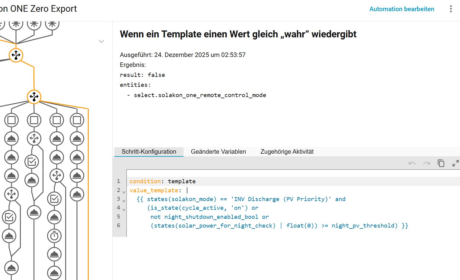

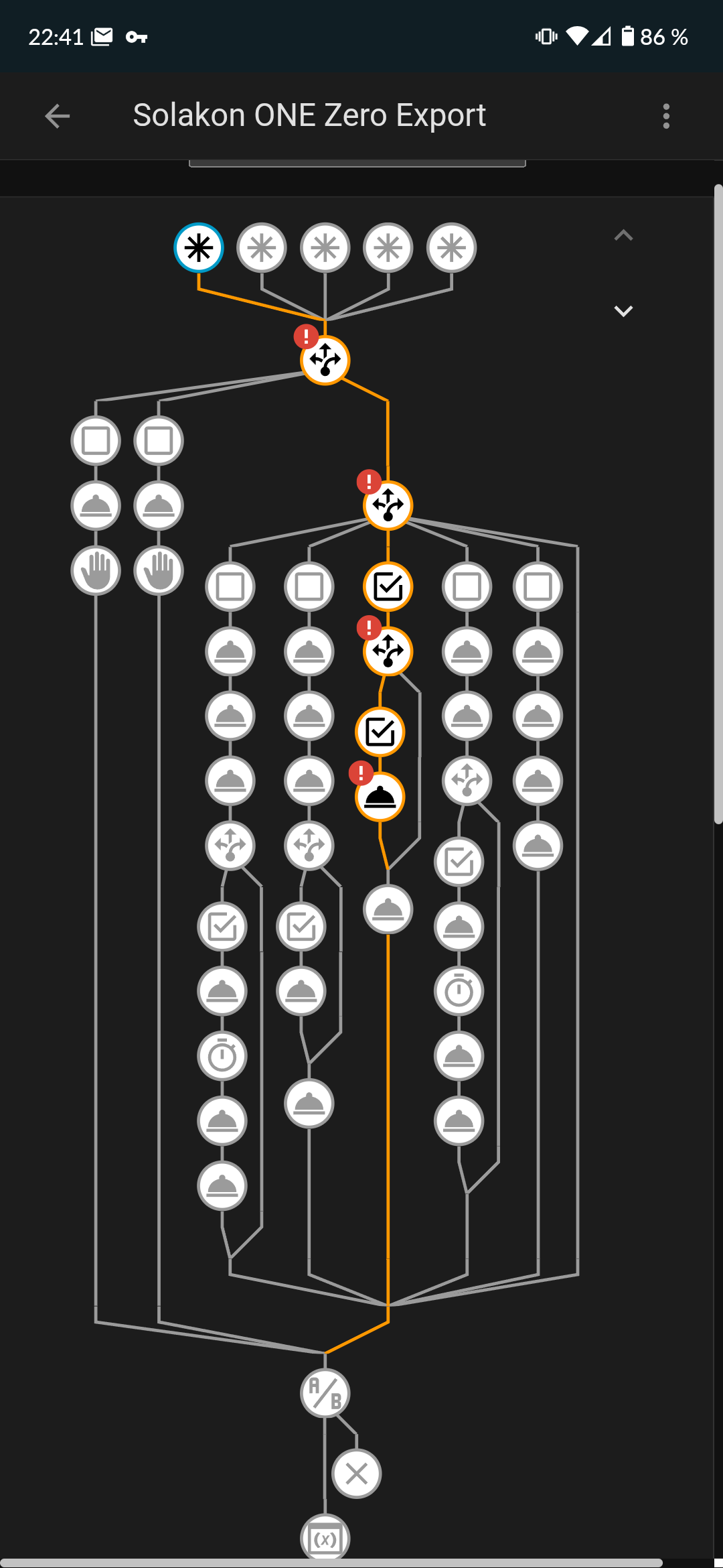

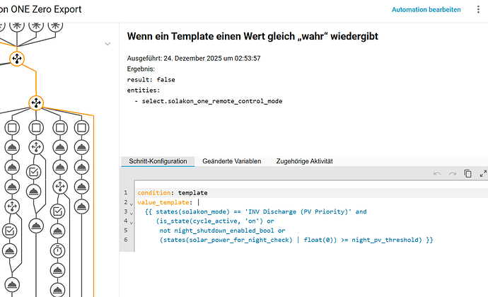

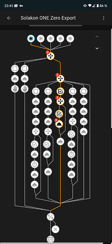

I installed and configured this Blueprint and it shows an error when running:
Error in describing trigger: Cannot read properties of undefined (reading ‘includes’)
Ausgeführt: 8. Dezember 2025 um 09:52:55

Hi, had the same Problem. The trigger section needed some modification.
triggers:
- trigger: state
  entity_id: !input grid_power_sensor
- trigger: state
  entity_id: !input solar_power_sensor
- trigger: numeric_state
  entity_id: !input soc_sensor
  above: !input soc_fast_limit
  below: !input soc_conservation_limit
- trigger: state
  entity_id: !input mode_select
Hey,
tried the trigger alteration. Now it occoured an other problem.
Any hints?
Maybe this helps?
repaired triggersection and renamed the changed workmodes should work correctly now
