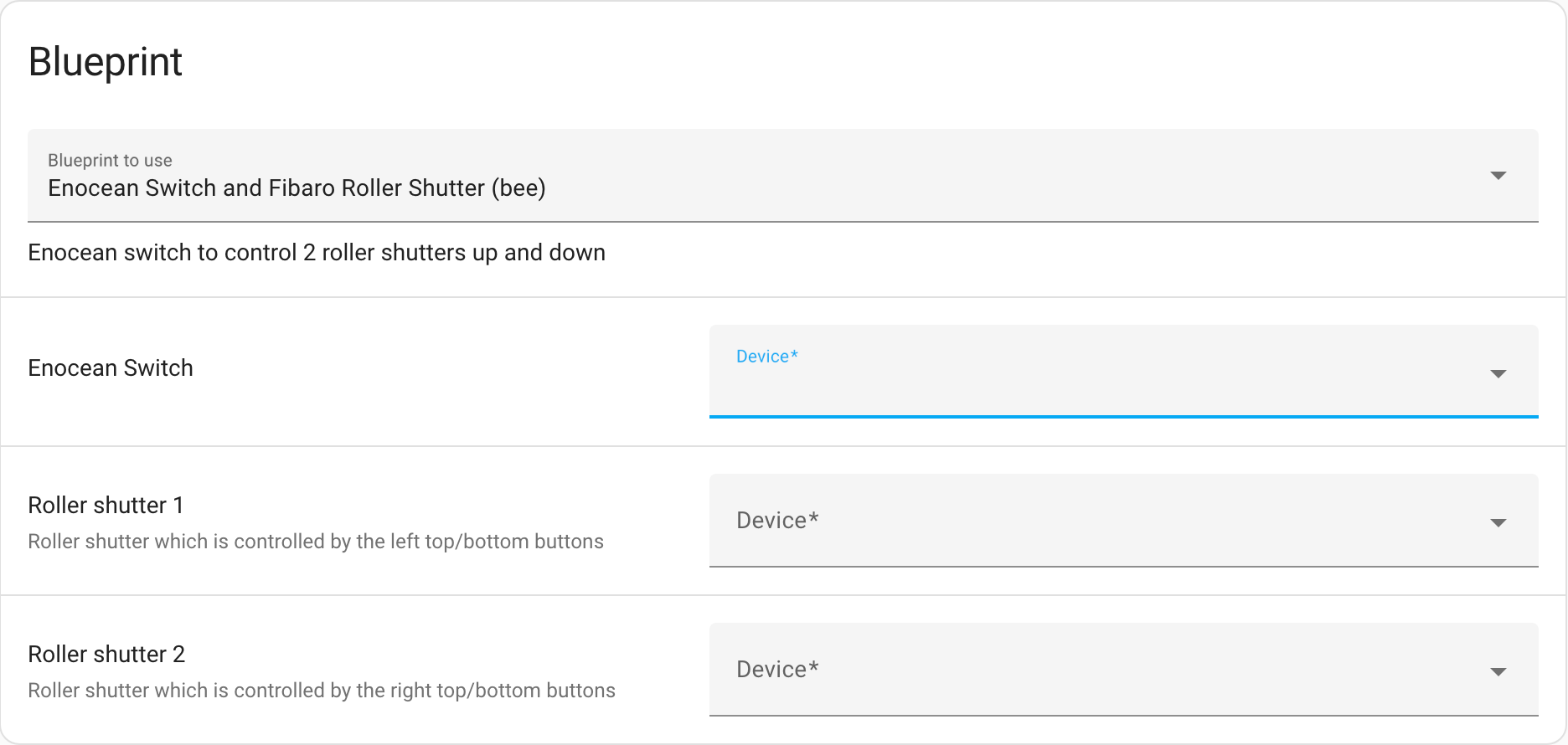

I took the blueprint SmartHomeForDummies/HA_Blueprint_EnOcean_Eltako_FT55_DE.yaml and could get to work everything. Now I am trying to create my own blueprint and to adopt the work of SmartHomeForDummies for my use case (I need to control a lot of roller shutters, so I want to simplify it).
Now my issue is, that I do not know how to access the hex id defined as id: [0x00,0x2D,0x5B,0xD4] of the switch to be used in a button pressed event. The original blueprint requires it to be entered manually, but I would want to select an entity in the blueprint (such as “Light Switch” or “Roller Shutter Switch”) and the get to the hex id from configuration.yaml

Well, my idea was to create a blueprint so I can easily hook up EnOcean switches with roller shutter devies. This would have looked like this:
Therefor I would have needed the ID of the EnOcean switch. But I couldn’t get it to work and to not loose too much time, I simply have built a number of automations.
