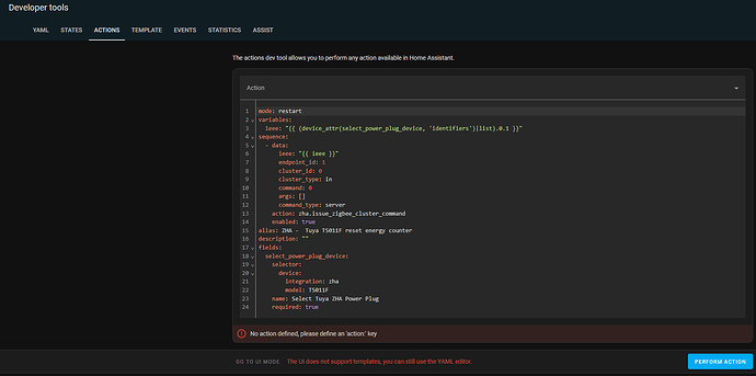

Works great, thanks. Modified it to a normal script (adopting the blueprint), with the device as input parameter. To be used interactively in development tools-> actions. Functionally it is identical to a script based on the blueprint:
mode: restart
variables:
  ieee: "{{ (device_attr(select_power_plug_device, 'identifiers')|list).0.1 }}"
sequence:
  - data:
      ieee: "{{ ieee }}"
      endpoint_id: 1
      cluster_id: 0
      cluster_type: in
      command: 0
      args: []
      command_type: server
    action: zha.issue_zigbee_cluster_command
    enabled: true
alias: ZHA -  Tuya TS011F reset energy counter
description: ""
fields:
  select_power_plug_device:
    selector:
      device:
        integration: zha
        model: TS011F
    name: Select Tuya ZHA Power Plug
    required: true

Unfortunately, it doesn’t work for me. What I’m doing wrong?
Is the following interpretation correct?
cluster_id: 0 → Cluster Basic (Endpoint id: 1, Id: 0x0000, Type: in)
command: 0 → reset_fact_default (id: 0x0000)
I ask, because my plugs do not reset when i commit this command.
I am using the sonoff dongle, so that could be the problem!
Any ideas so far ?
