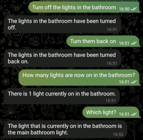

:backhand_index_pointing_down: Example:
This example uses an LLM
