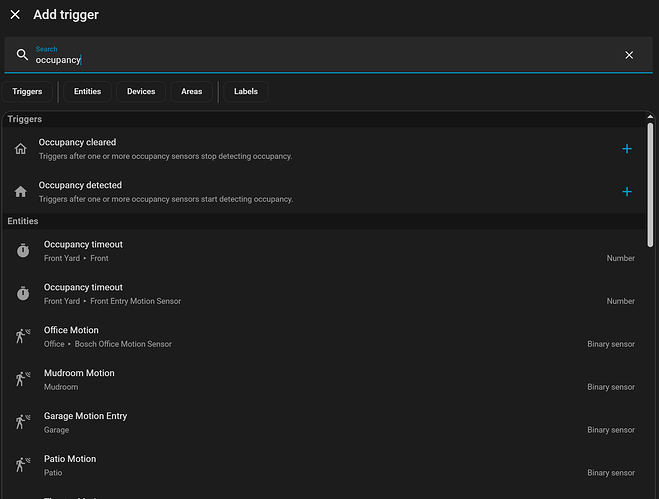

Blueprint Trigger Selector some Motion Sensors "no triggers available" .... Bug Reported

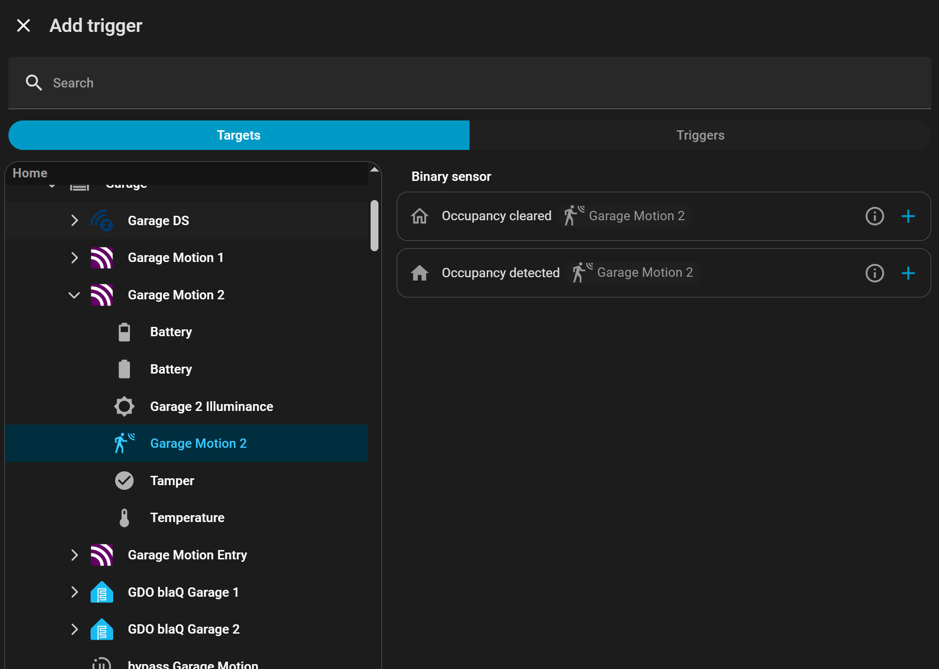

Identified Root Cause of BUG … If the entity is “Show As” = “Occupancy” it works fine in the selector… when set as “Motion” the selector ignores it. Hope this gets fixed in the next release.
ALL motion sensors, and all entities for that matter, should show in the Trigger Selector no matter what the “Show As” setting is set to. Triggers should be based on the Domain type and should not include/exclude that “Show As” has.
posted bug report… Trigger Selector Bug - some Motion Sensors “no triggers available” others work fine · Issue #29191 · home-assistant/frontend · GitHub

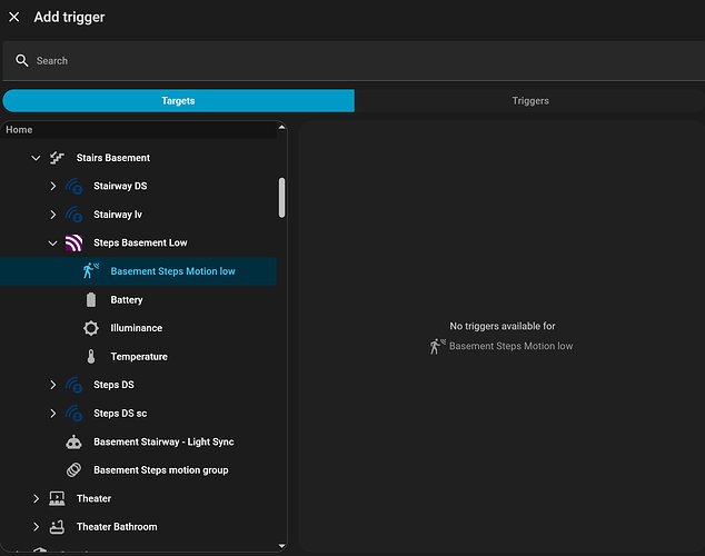

I’m creating a blueprint using Trigger Selector. Some motion sensors works as expected, others do not work at all in this selector type.
the selector “sees” the sensors…

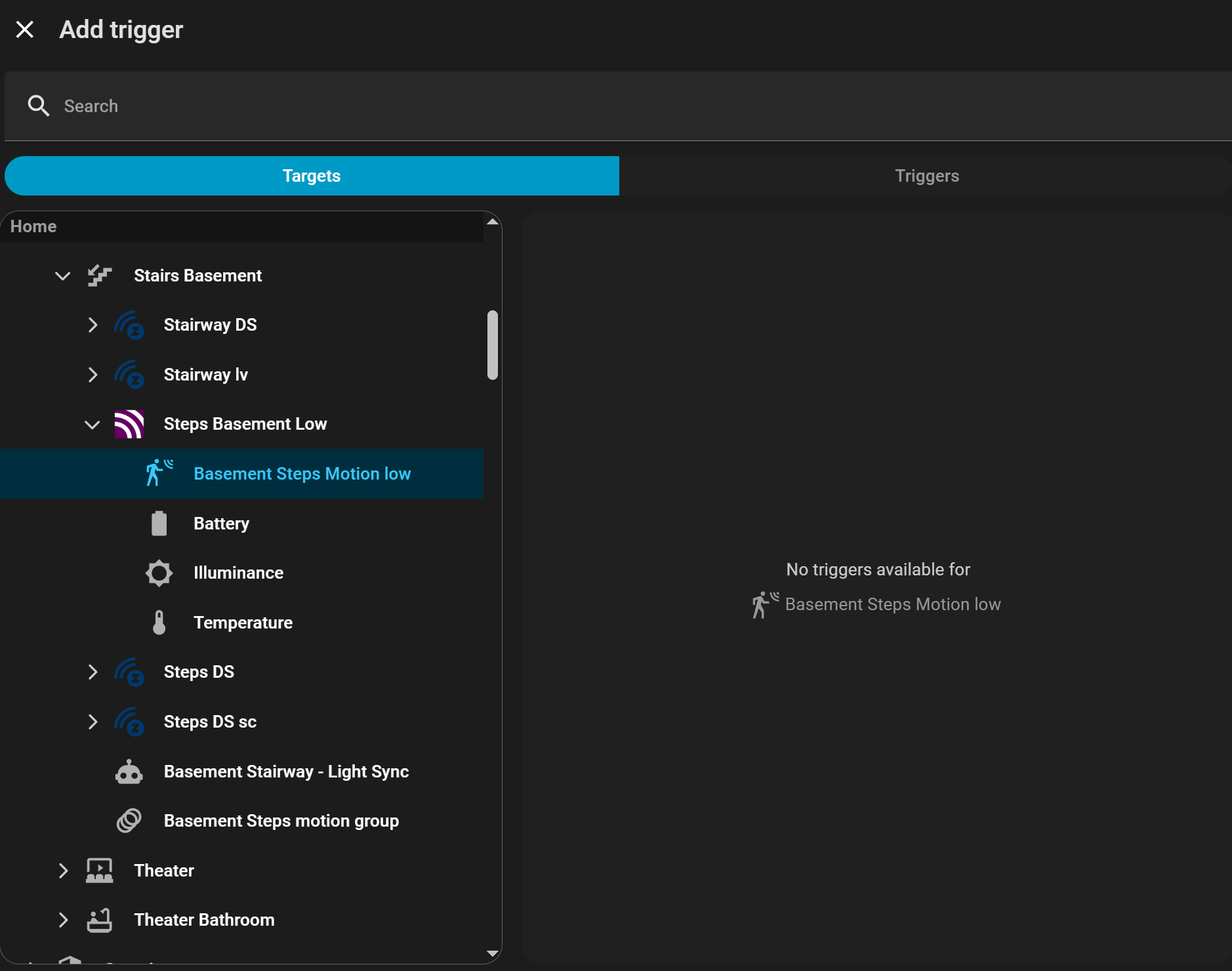

then when I choose one:
Sometimes it works fine…
Other times it fails…

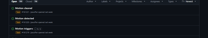

Motion triggers don’t exist yet. This is a work in progress which is why it’s in labs, you can see them listed in github by filtering to only show tasks.

The trigger literally doesn’t exist. You’re using the experimental labs triggers. Only half exist at this time.

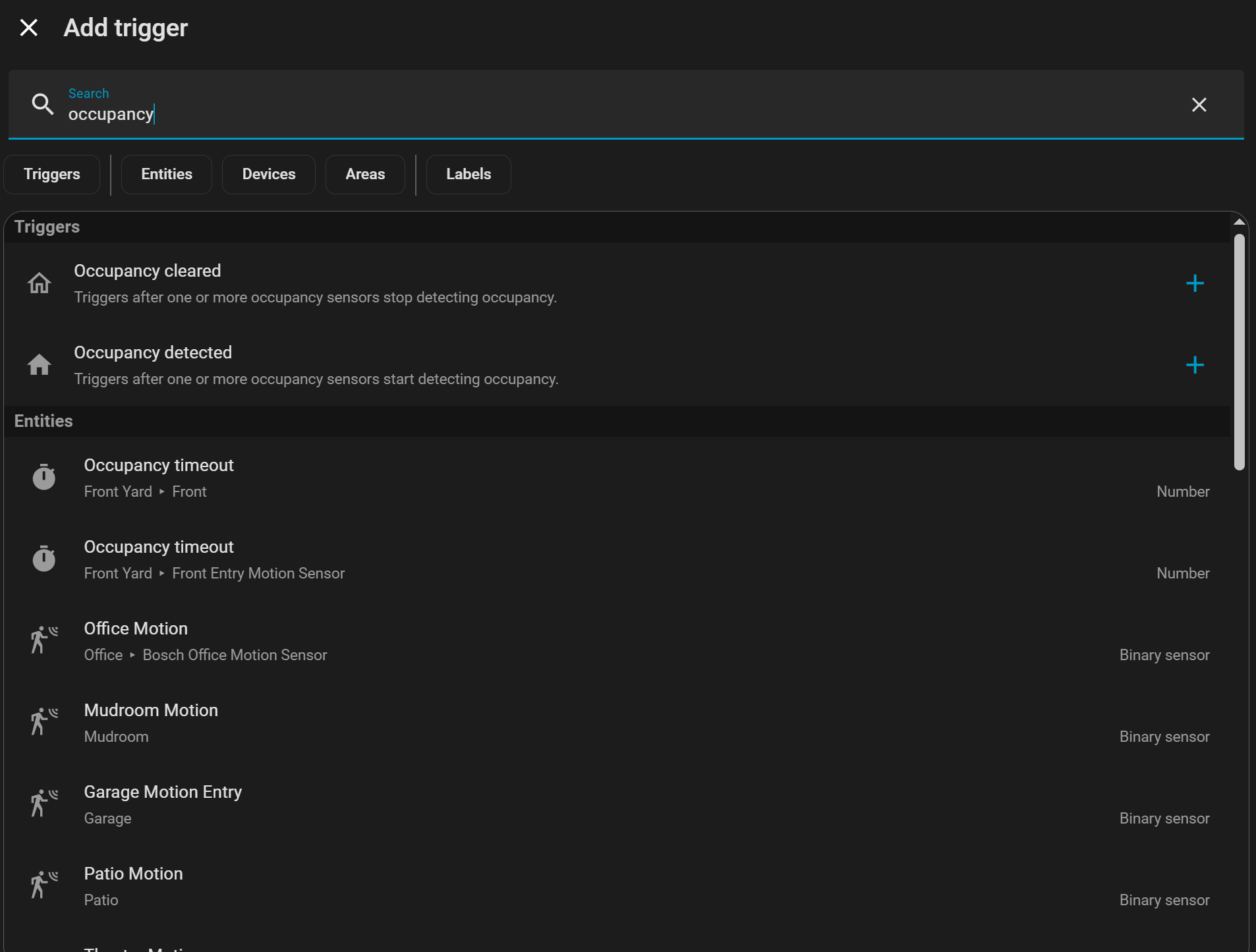

Occupancy trigger does exist, and it works – I have several automations using it.

My guy, you’re asking about Motion triggers… It does not exist.
I’ve literally linked you the github tasks that will eventually create the Motion triggers and you’re here saying “they should exist”.
No, you are using Occupancy triggers, they are new. Added in december/january. You’re asking about Motion Triggers, they are not in the software yet. Both of these triggers are the “new style triggers” and are only accessible via labs. This is a work in progress and the work isn’t done. Obviously it’s not as simple as you’re making it out to be otherwise the motion triggers would already exist.
Aside from all of that, they will be in the software shortly. So even saying “they should be in the software” is pointless because there’s a task showing they will be.

If you want a trigger that is based solely on state value, you need to select a State trigger in the selector not one of the experimental “purpose-specific” triggers.

occupancy: on means occupied (detected), off means not occupied (clear)
motion: on means motion detected, off means no motion (clear)
in regards to the new trigger system, it specifically points out the device_class for how it filters. That’s just how it works. There’s nothing more to this. There’s nothing more to understand.
Yes, technically speaking this can be expanded easily to other device_classes, but it hasn’t. There’s literally nothing more to this other than the work has not been done. That work is literally just a yaml file pointing to the device_class (for filtering the trigger selector) with some translations for the UI.
Different people like to organize and use entities based on different models. The devs have elected to add triggers and conditions to the new feature based on device class first. My guess is that they are doing so to iron out issues before moving to a broader scope. Based on previous discussions on Discord and the fact that there is still a domain-wide open task for binary sensors; it looks like there will be broader-purpose or combined triggers so you can trigger off a selection of binary sensors even if they do not share a device class, or all members of a binary sensor group, or all binary sensors that share a Label.
