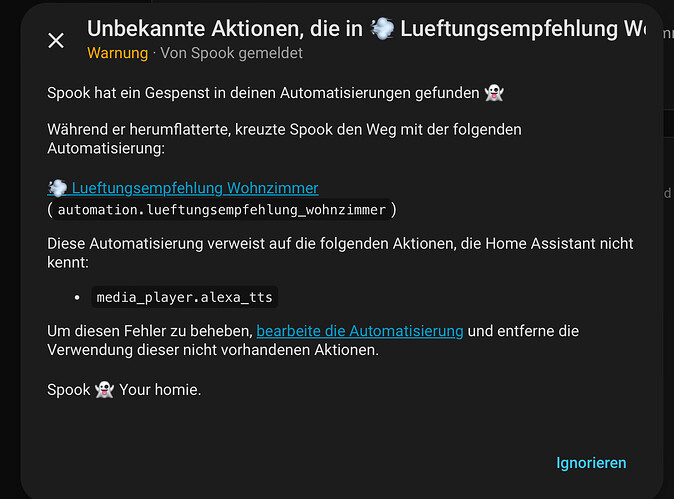

v0.4.4 (25.02.2026)
  • Alexa native integration: Multiple devices selectable
  • Bug fix: Native Alexa service corrected to notify.send_message
